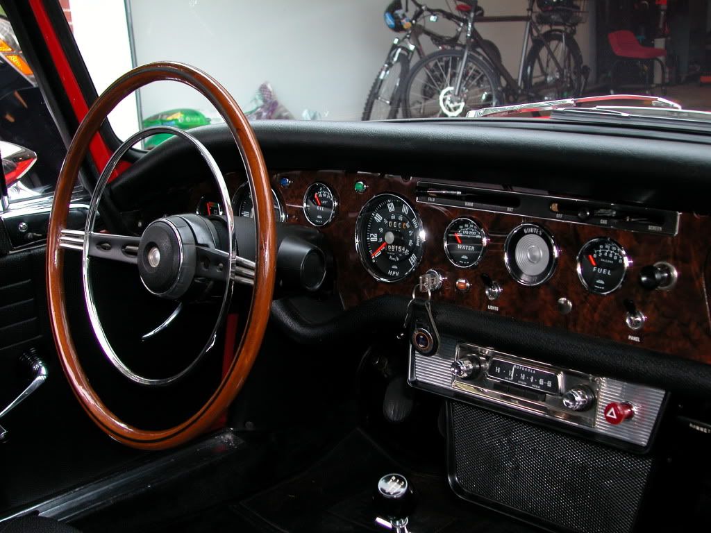

I got a reproduction with the metal body vs. the cardboard that included a working correct radio for $500 a few years back. Was found in the bay.
The red knob is a Lucas emergency flasher unit that can be purchased from Victoria British. I used all the correct colored wires and bullet connectors (http://www.britishwiring.com/) to install it.
