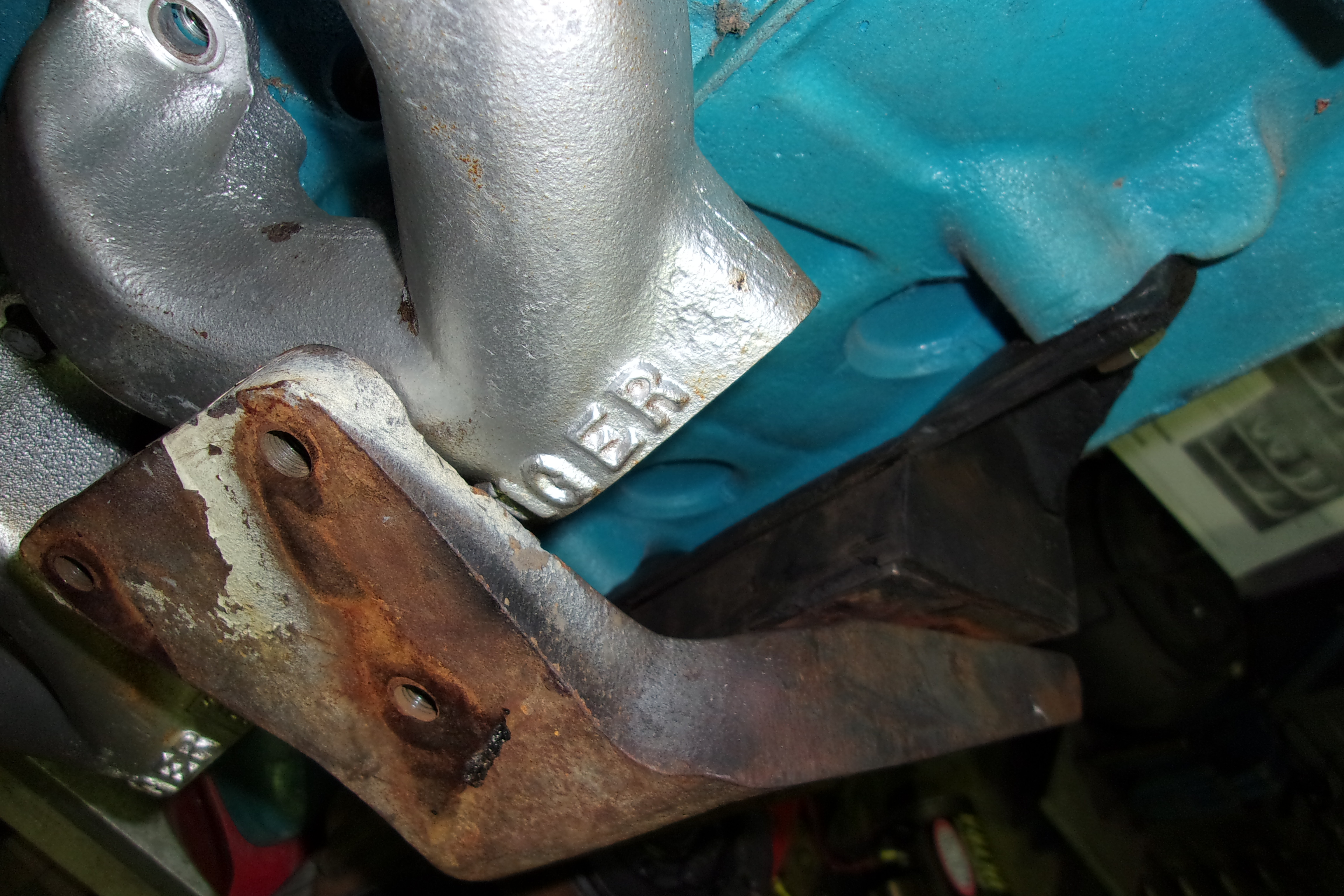

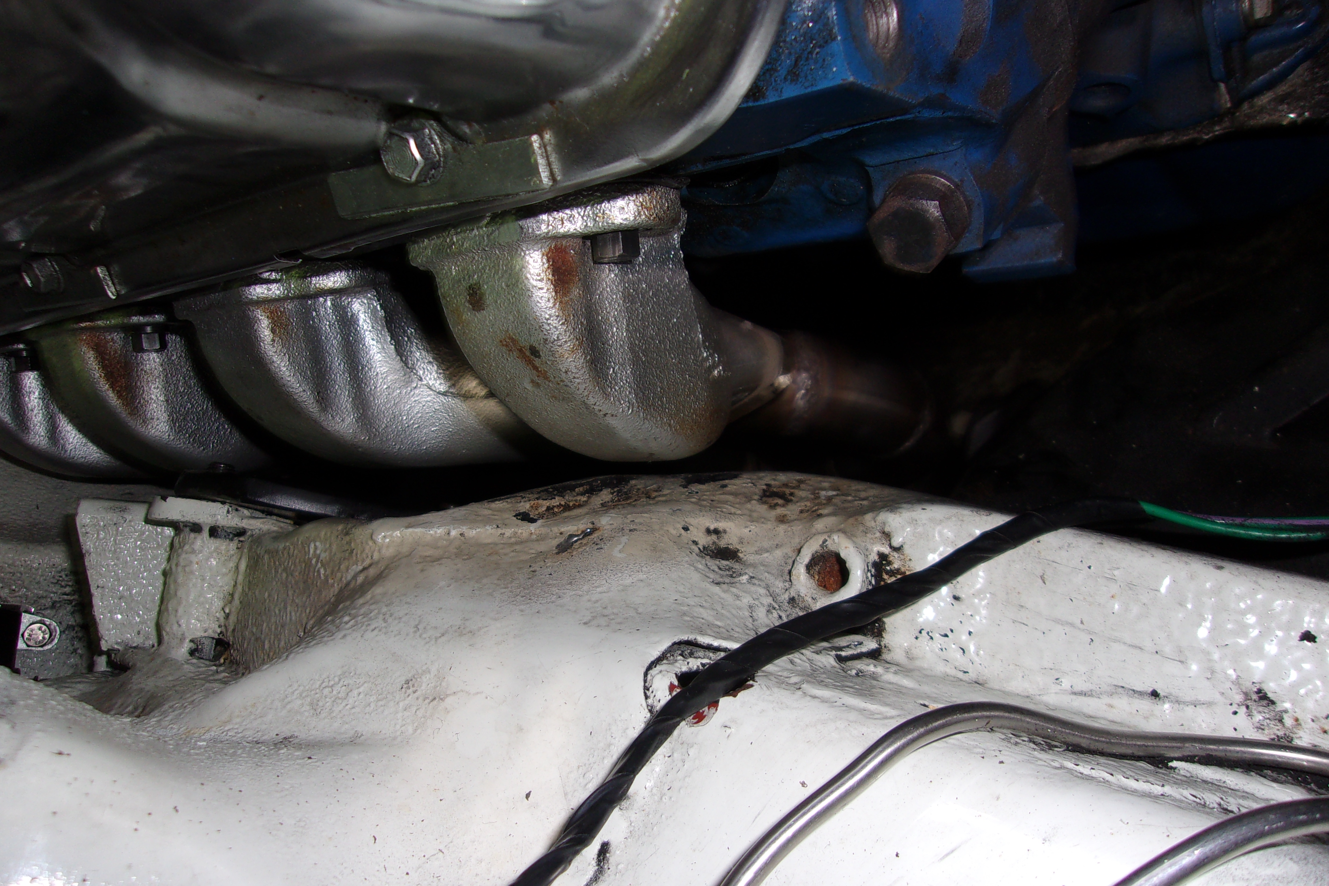

Here's a photo that shows the interference between the cast header and chassis mount, there is a large gap at the motormount to the chassis mount, I have another photo with a 3/8 bolt laying in there for scale. To get the motormount to seat onto the chassis mount I made the new chassis mount with just the 2 holes. Yes, that motormount is the old one and is slightly compressed and I have a new one to replace it but the difference between them is not significant.

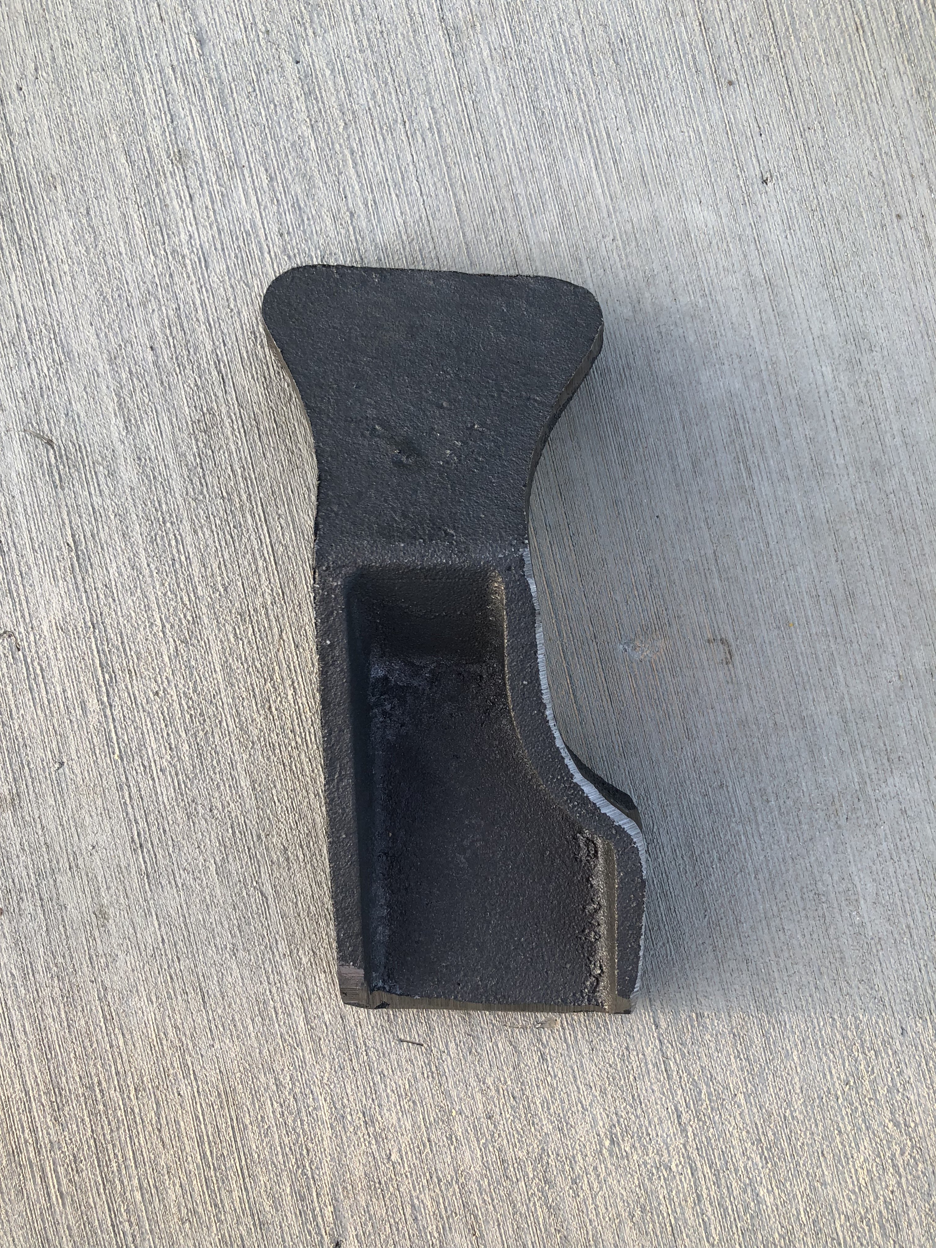

Here’s the mount you received when you purchased the kit. You can see the area removed from the original which would allow installation.
ojxx,

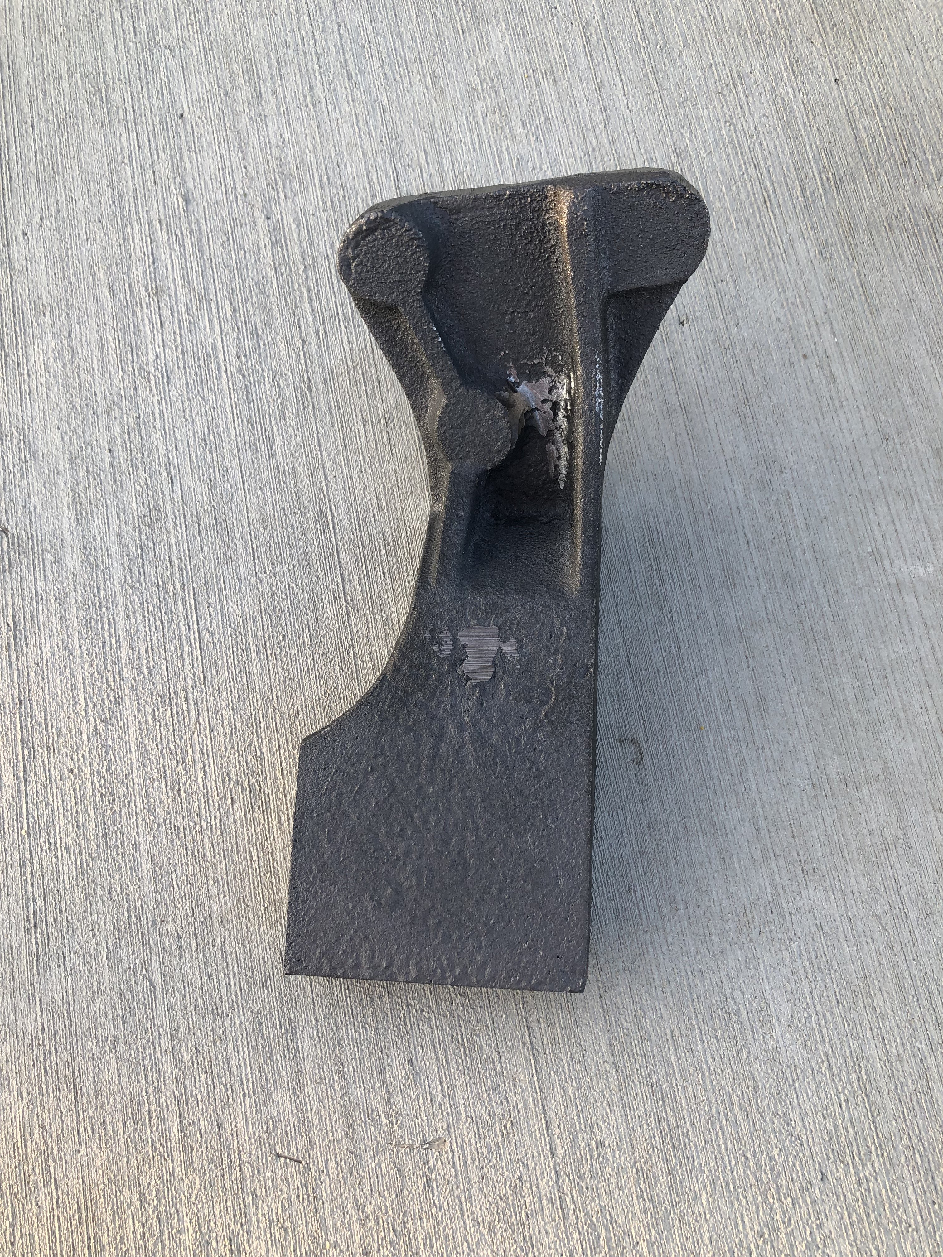

In case you're interested, I got my first samples from the foundry of the reproduction LAT chassis mount. They do not address the issue you are having with interference between the manifold and the top forward mounting hole but they do have clearance for the down pipe, same as the originals.
Some finish work still needs to be done and the holes need to be drilled and tapped.

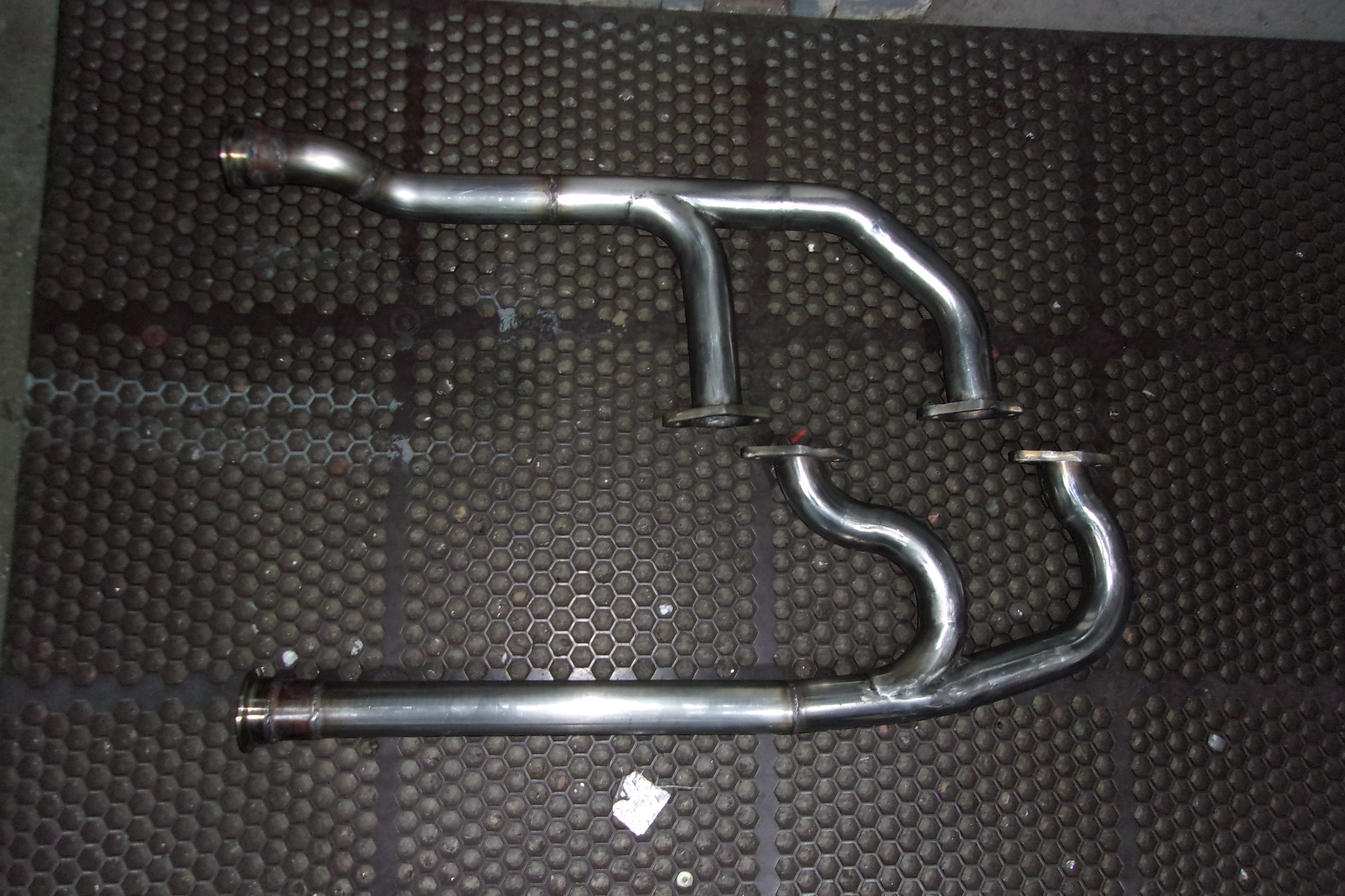

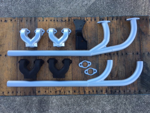

Here's the left side tube
The right side manifolds and headers with the chassis mounts, I don't have the motor mounts in yet.

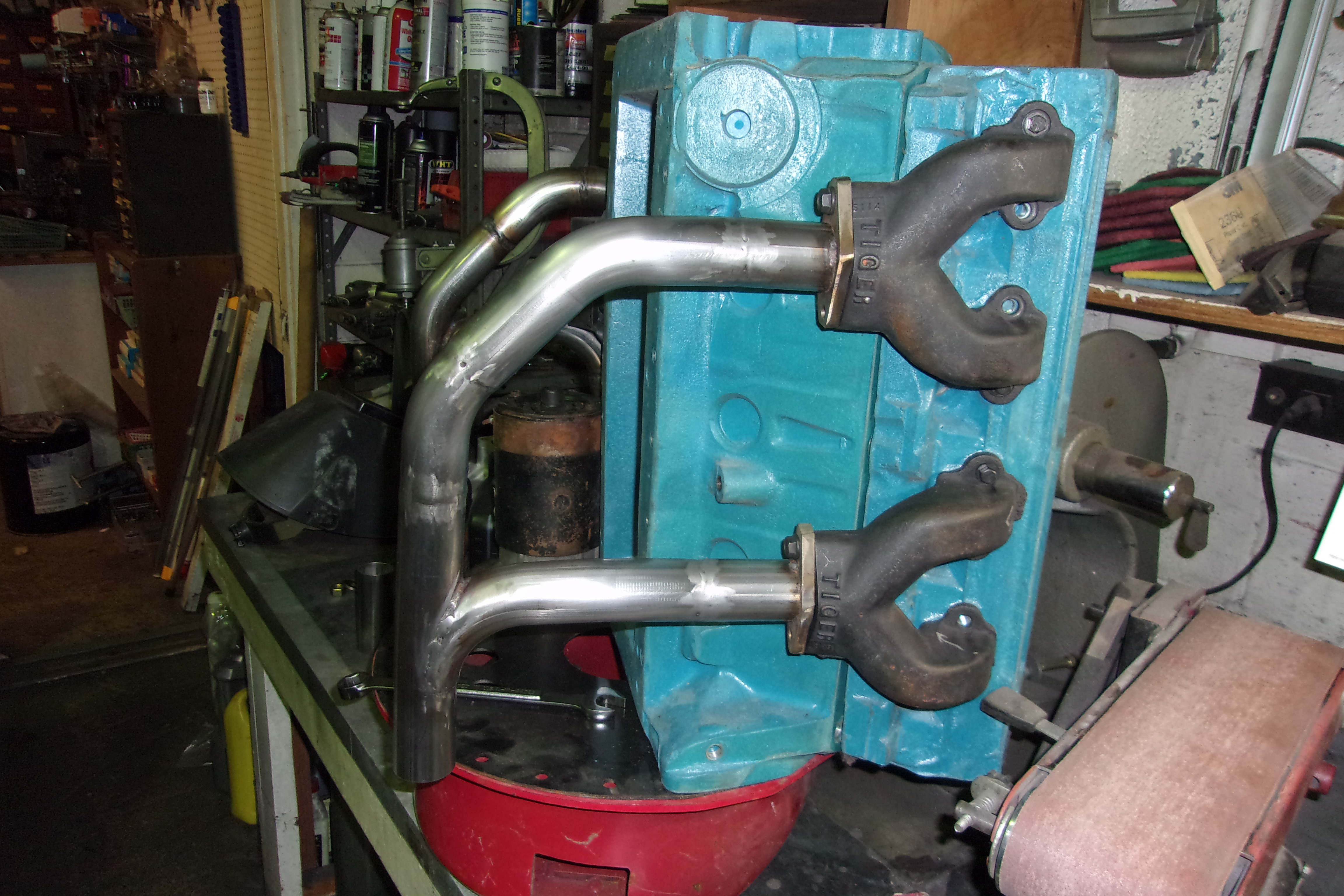

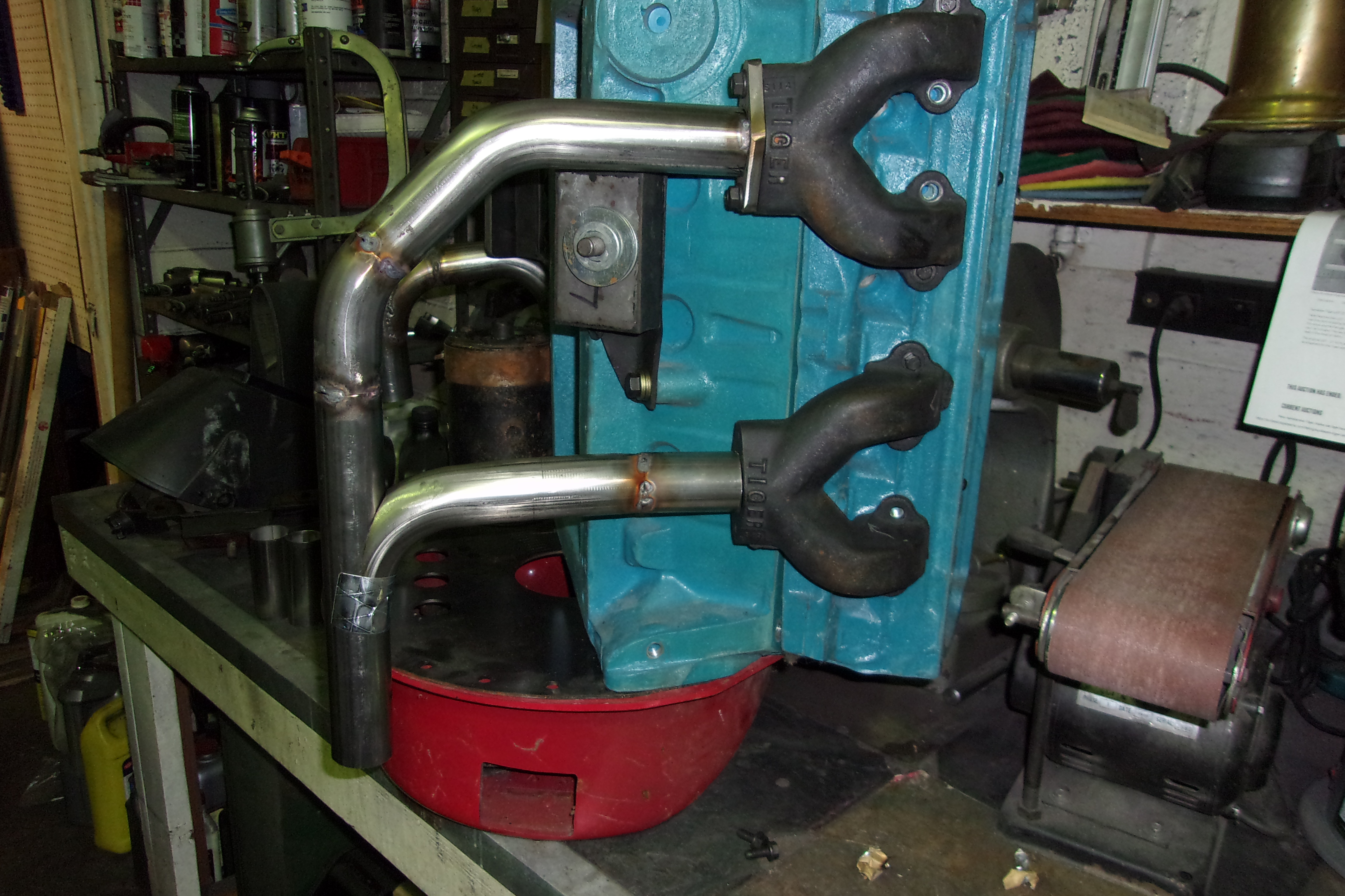

I assembled everything for a final mockup in the car and I didn't care for it. The headers dropped down too low so I took it all back apart, cut the headers apart and shortened them by about 2", heres a mockup on the bench with the new PowerMaster Starter:
I've ordered some stainless flanges to mate these to the exhaust, hopefully they'll be here tomorrow.
There's a problem I see in the final mockup, I have no idea how I'll get that one bolt from the front tube into the Y castings, its behind the chassis mounts as if I have to take them out to get it up in there. It's a puzzle.

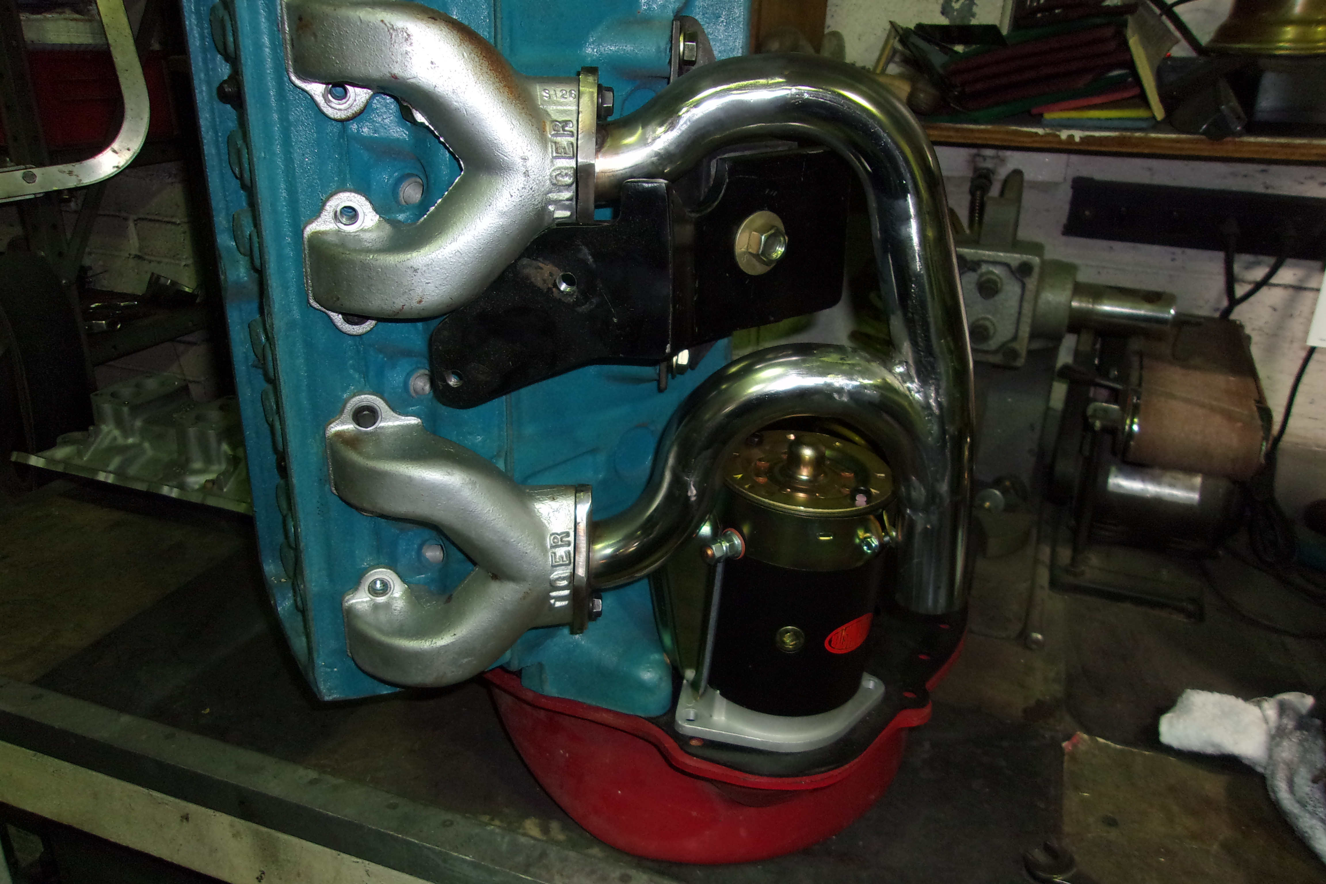

Well, here they are

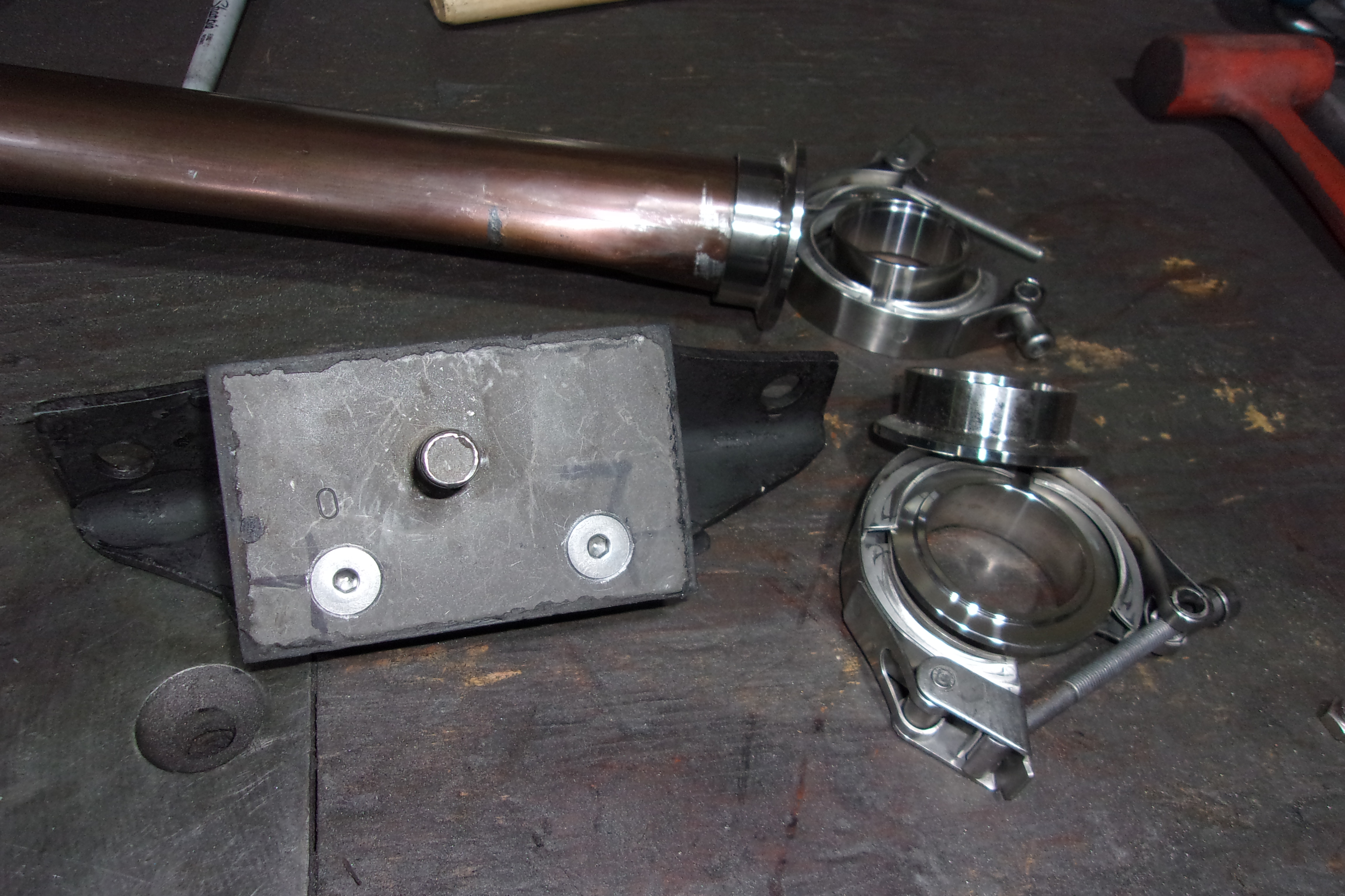

I wound up using a 'V' band clamp instead of the flanges. To bolt the headers up I have to take the motor & chassis mounts off, bolt these to the castings, assemble the motor & chassis mounts and let the engine down then run the bolts into the chassis mounts. The starter bolts up without messing with the headers.
I wonder if these replacement motor mounts are at the right angle? They'll bolt up because of the rubber but I believe that that is the root cause of the chassis mount/header interference? When I bolt the chassis mount to the frame the motor mount stud passes thru it but the mating surface angles are off.
On the drives' side I made motor mount travel limiters from countersunk 5/16ths stainless bolts so it seats flush to the chassis mounts (the 'V' band clamps are also in the photo:

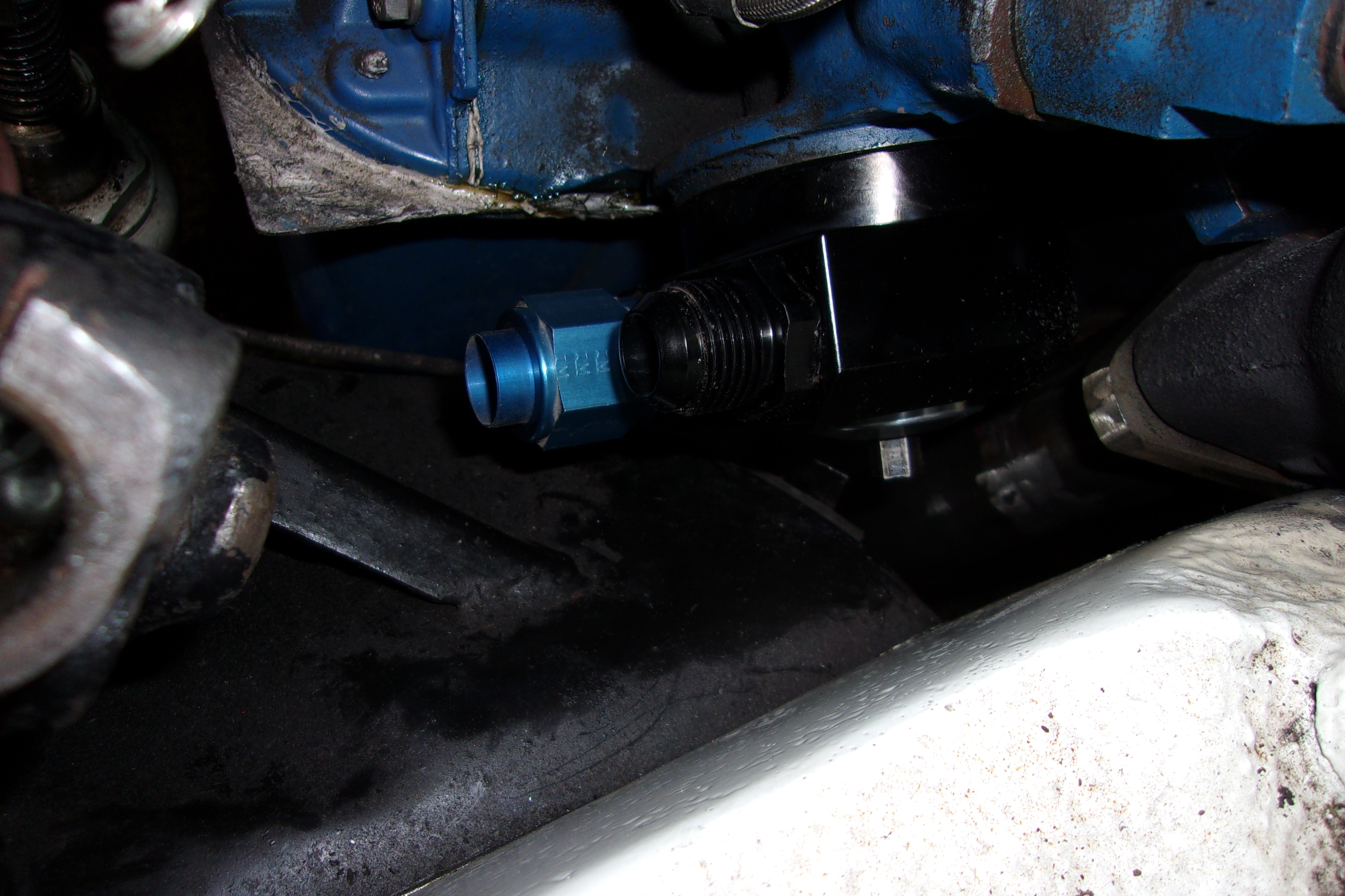

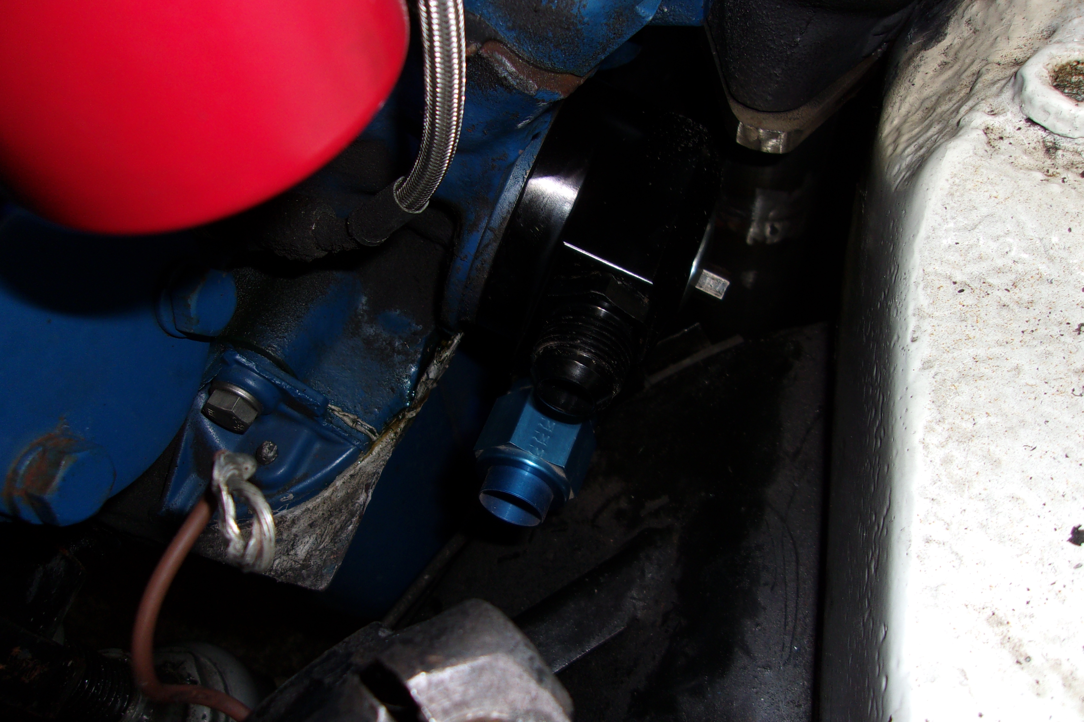

To complete the headers I had to relocate the oil filter, the owner wanted it inside the left fender, behind the headlight. I planned to use the filter adapter from Earls and make stainless tubing to the remote housing but the bends were too tight and I used stainless braid hose & fittings.

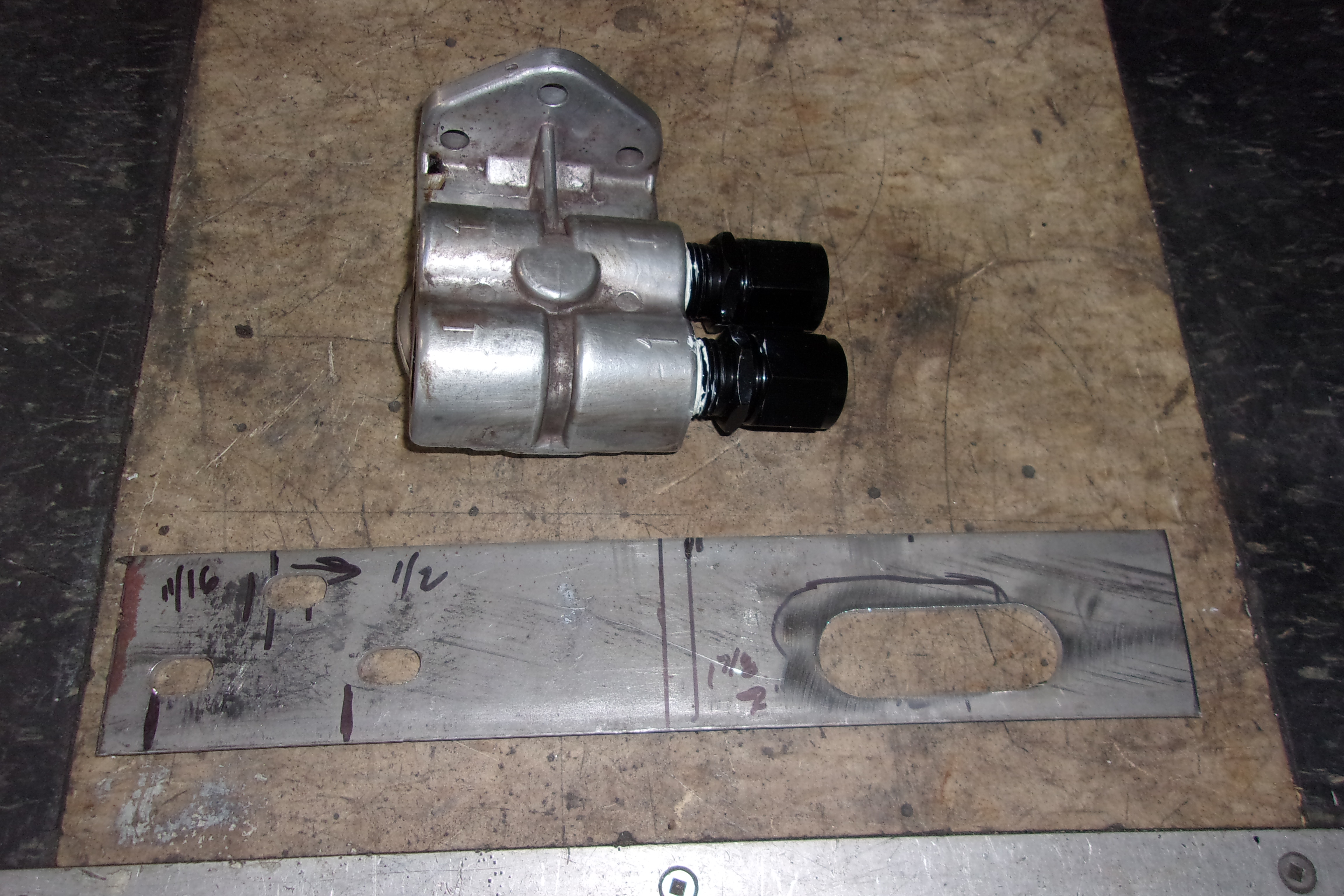

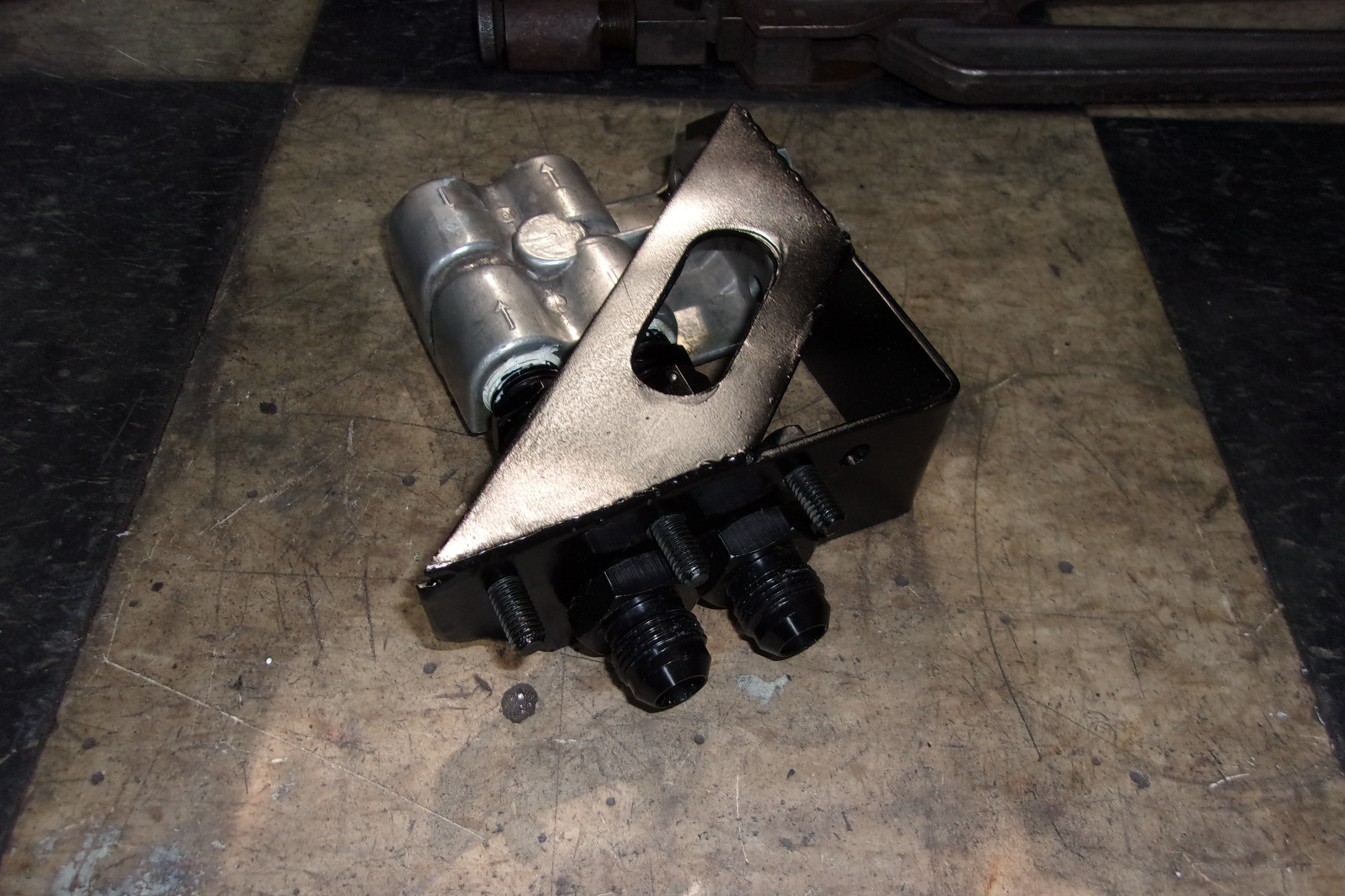

This is the remote filter adapter and the makings for its' mounting bracket

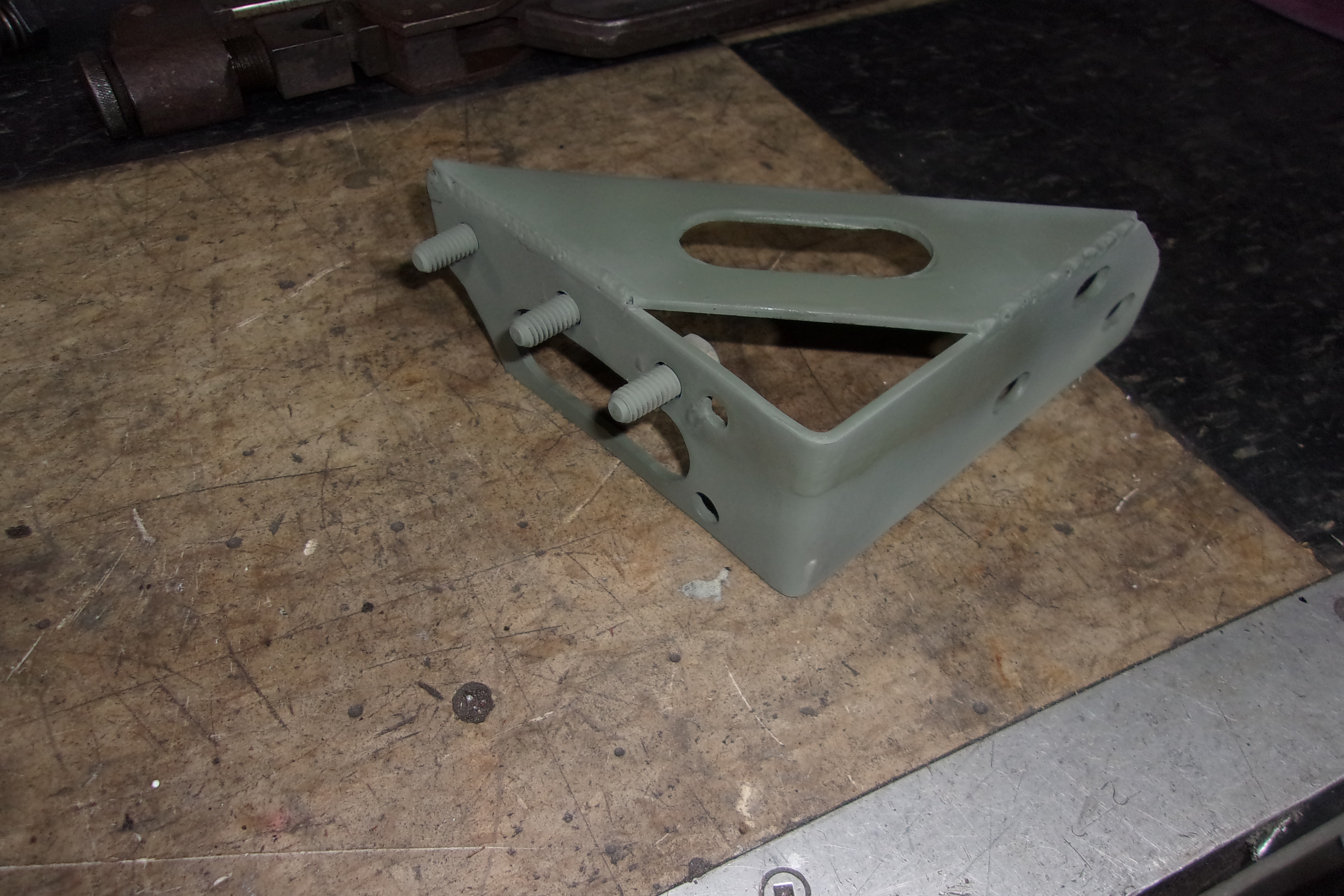

I bent the bracket added a strap brace and welded in some mounting studs

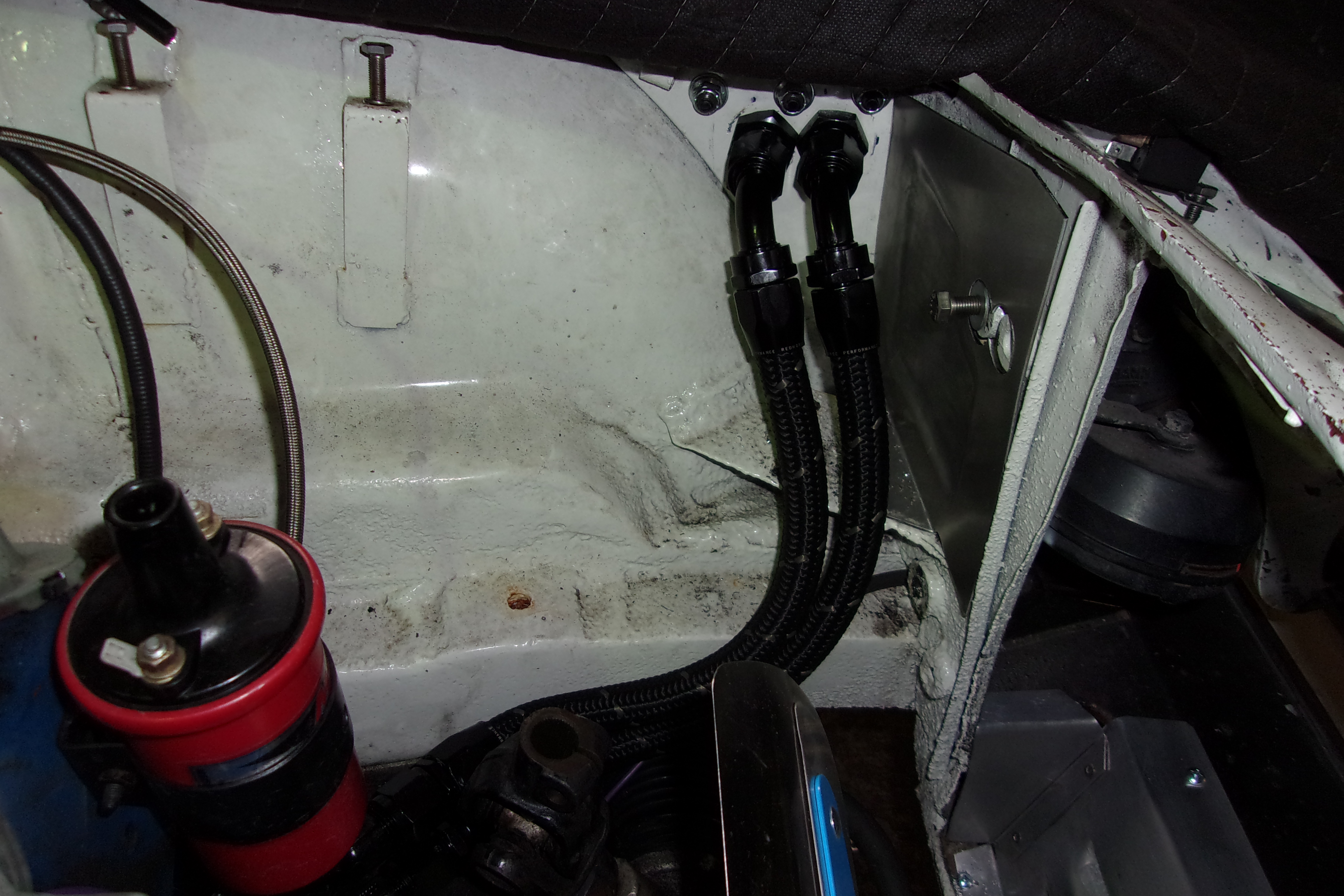

Here's a mockup of the assembly with the -AN bulkhead fittings

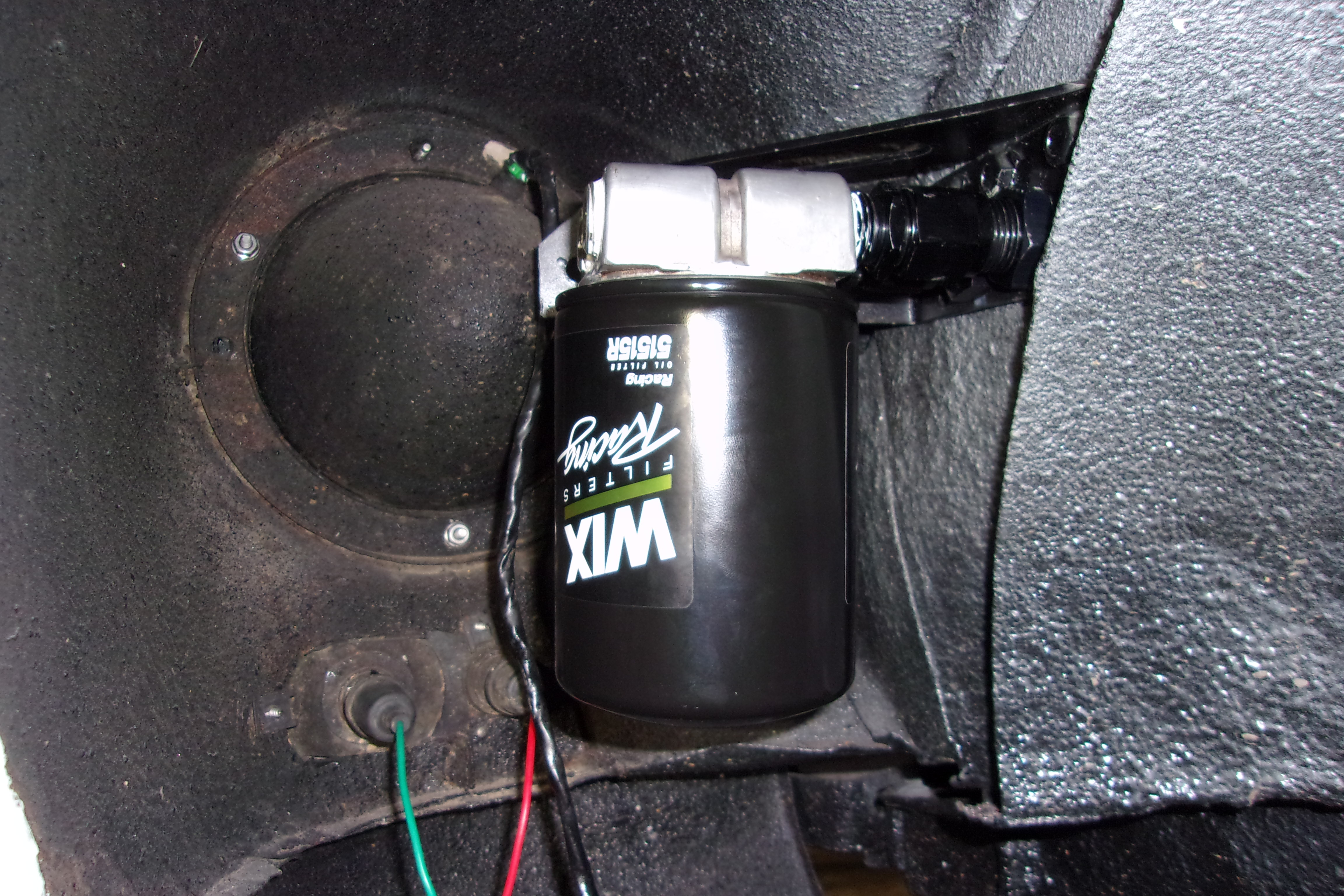

This assembly gets mounted inside the fender, the left headlight cable gets pulled back and the hole gets enlarged for the left bulkhead fitting, holes drilled for the right bulkhead and mounting studs. The hose is -10AN nylon with internal stainless braid, a little more flexible than typical stainless braid
And the filter
