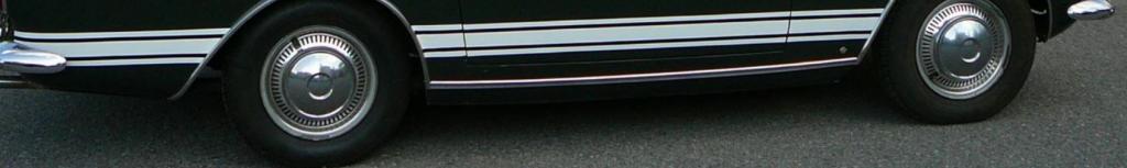

Almost ready to install the molding on my MKII
Can someone give the exact distance of the sill molding under the front and the rear of the door , also the distance for the chrysler Pentastar
Thanks
Gilles
Gilles,
I measured the distance between my rocker panel sill molding and the opening in the body for the door (not to the bottom of the door), in case there are any variations in how the doors are hung. At the front of the door opening, I measured 2-1/8" to the top of the molding and for the back I got 2-3/8".
For the Pentastar, I measured 1-3/8" from the top of the rocker panel sill molding to the CENTER of the Pentastar. I also measured from the top of the seam between the rocker panel and the fender to the center of the Pentastar and got 8-1/2".
All measurements were made with a tape measure.
