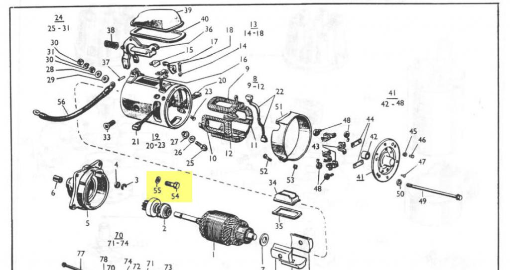

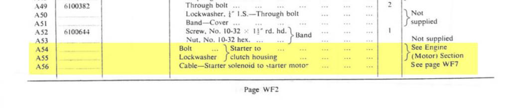

According to the Parts Manual, the starter bolts should be 3/8" x 1". Attached is a screen shot of part of page WF2. It refers the reader to the Engine section. (Note that it also refers to page WF7. This has to be a typo from carrying over from the pre-289 Parts Manual, as there is nothing about the starter motor or the bolts on WF7. Also attached is from Plate A of section WF, showing a diagram of the starter motor, including mounting bolts.

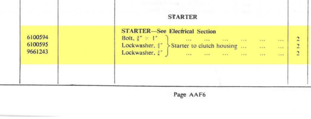

The other attachment is from page AAF6 from the section for MkII engines. It specifies the bolt size.
I would suspect that these bolts are not fine but are coarse.
