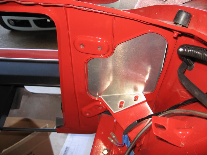

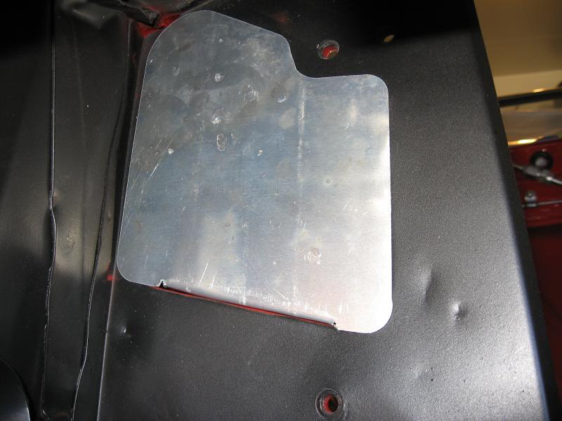

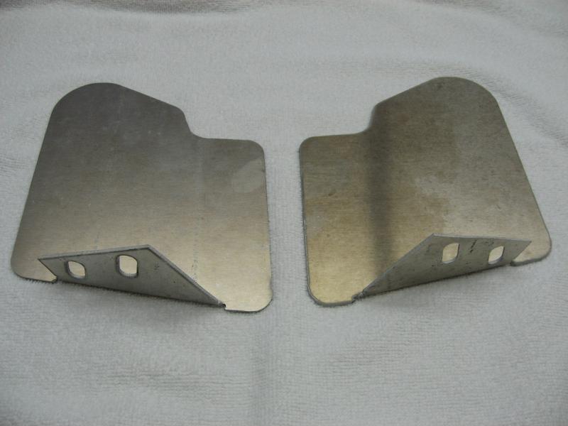

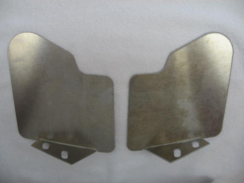

I recently created Tiger horn hole block off plates for my car and they came out really nice and are pretty simple to mount using the existing horn mount. The plates come from a computer generated pattern and are made from water jet cut aluminum. The plates look like they could have been an option and not like some afterthought created in my garage, they can be painted or left in the aluminum finish. I'd like to make these available but need a minimum order of 8 pairs to get my guy to make them in quantity @ $32.00 a set. I've got mine so if you want yours get in contact with me and I'll get yours on order. In everything I've read this is one of the easiest ways to address Tiger overheating issues and can drop engine temp up to 5 degrees or more. If you'd like more info or have questions call me 503-384-9517 or cell 503-799-8702.............I hope this might help some of you who have been wanting to install this improvement on your car. Cheers, Don Lutjen

They require removal of horn or just fit under existing horn to block extra opening ?

These block off plates will use the existing horn mounting platforms. If you're using stock horns there is an area that will be outlined on the plate that will need to be removed to alleviate interference. This area is approximately 1.5" high and 2" long rectangular in shape, this will only be necessary on the drivers side plate. The passenger side will require a small spacer on the left hand side and under the mounting plate and will be included. There is no problem with the engineering, I'm just trying to make them versatile and usable by those that keep those heavy Rootes horns or opt to eliminate, replace, or relocate horns. My intention is to make this as simple as possible as these cars are already a pain to work on. I think the benefits from these plates will out way any potential installation challenges. Mine pop right into place without horns and take no more than five minutes a side to install. I'll try to get more pictures on here.
