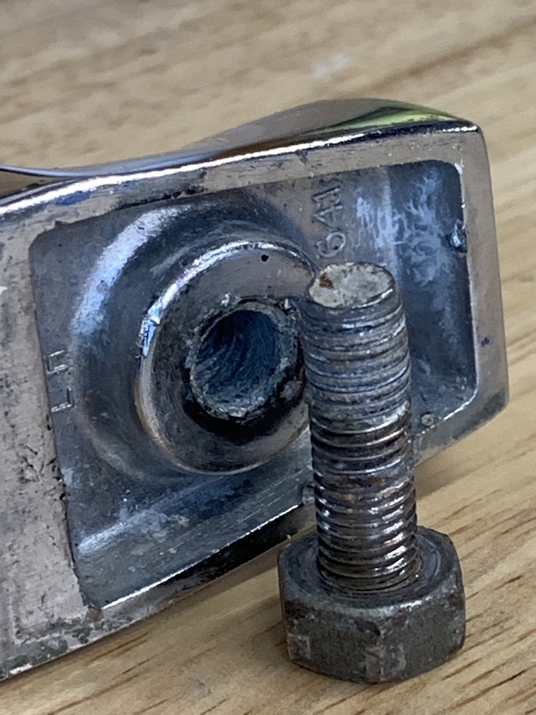

Dang, while replacing the trunk hinge gaskets, I noticed a stud had pulled out as I GENTLY snugged up the nut!

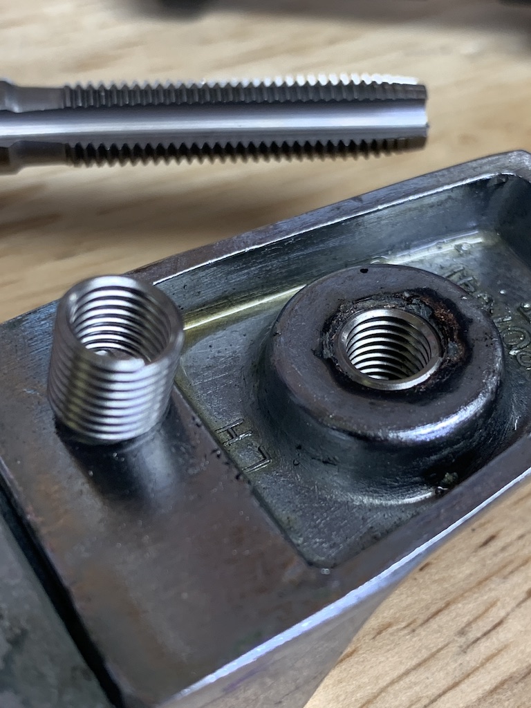

Debated whether to use a Time-Cert or Heli-Coil, went with the cheaper Heli. Tightened all back up with just enough torque to hold in place. Hope it holds.
