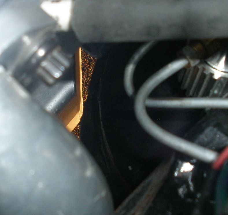

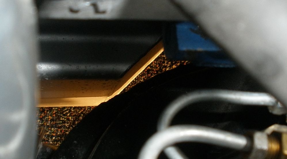

Here are a couple of pics I got of my clearance, not easy to get with all of the "stuff" in the way.
What am I missing here Duke ?????
You already said there were no issues with Dale's pan with a stock cross member. I just added that it's also a non issue with Dale's front end. It's not stock and it's not original but it is a very nice piece and worth every bit of what it costs. It turns the car into a very nice car to drive and I'm totally sold

Its cool, you just did not let the reading audience know that you have a Dale A crossmember when you posted that you have no issues. Dale uses Aviaid pans and they have proven to have interference issues with the OEM CM in the past. My pan, made by Armondo, does not have an issue in my car. Armondo used to make pans for Aviaid and must have adjusted his design.
