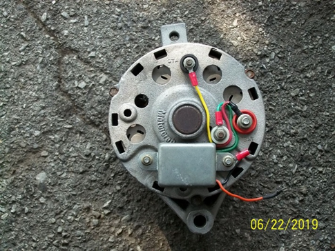

I converted to an alternator system 20 some years ago - B382 series Tiger. 1965 style Ford alternator with a small one wire voltage regulators mounted to the alternator.

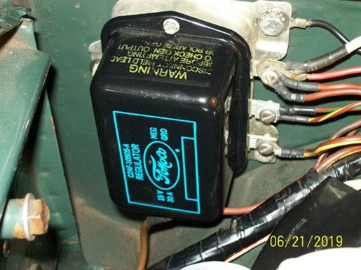

I made the original generator voltage regulator into a junction box to clean up the wiring.
Orange wire on new alternator voltage regulator to NG wire to junction box Field connection with NY wire to ignition warning light - ignition light works correctly.
