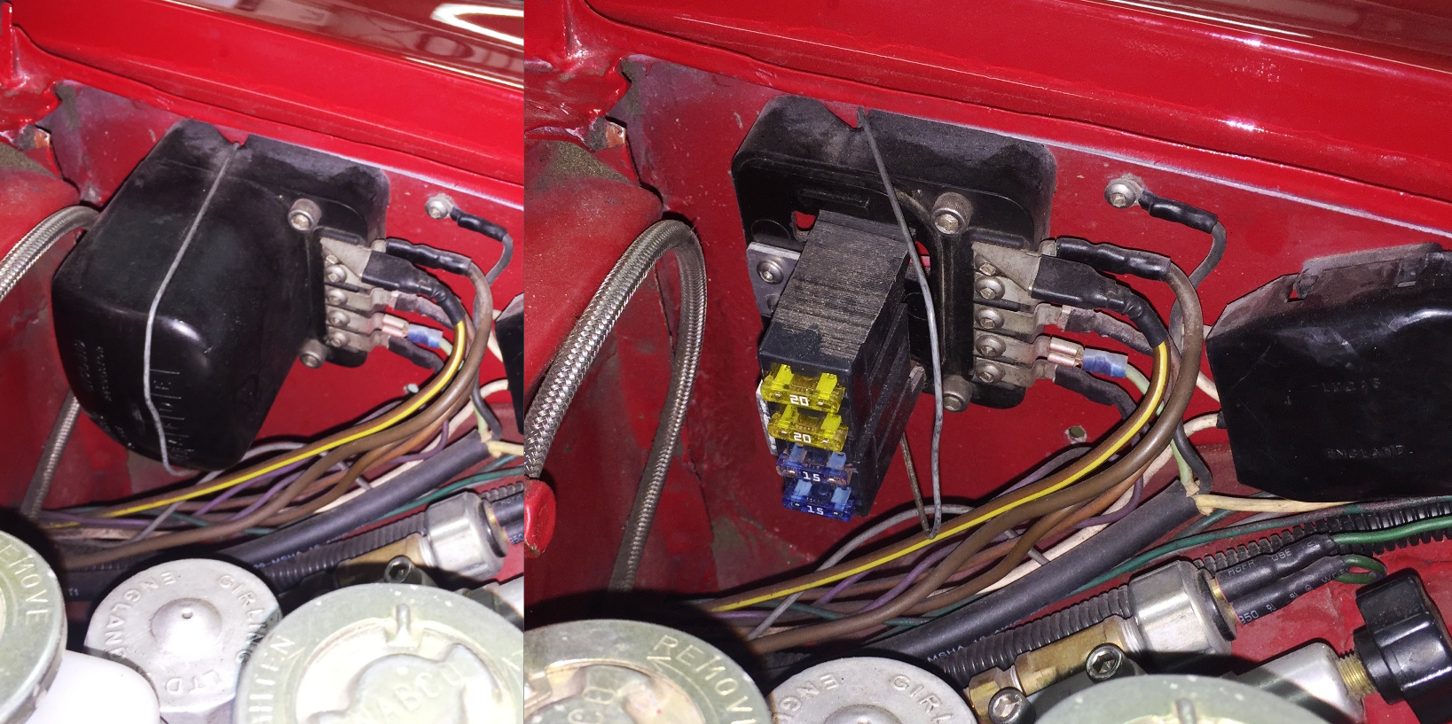

I did the same kind of thing... didn't like those unprotected circuits!! I jumped the key hot fuse box across the terminals so I also have 2 separate 'key hot' fused circuits II converted to an alternator system 20 some years ago - B382 series Tiger. 1965 style Ford alternator with a small one wire voltage regulators mounted to the alternator.
View attachment 19518 View attachment 19519
I made the original generator voltage regulator into a junction box to clean up the wiring.
Orange wire on new alternator voltage regulator to NG wire to junction box Field connection with NY wire to ignition warning light - ignition light works correctly.

used a denso style 3 wire alt so I could use the ign lamp
