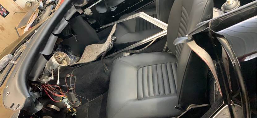

The car has been mechanically restored, with rebuilt engine, trans and diff. The body has also been cosmetically restored to a pretty high standard. The interior was also mostly restored with a new dash, carpets and seats. The shop owner has done several movie cars, including a couple of the Batmobiles, a Dukes of Hazard car and a couple of others. I have a really good platform to start from. The car just needs final assembly and sorting. The hard part right now will be identifying the parts that I have and figuring out what I don't have.

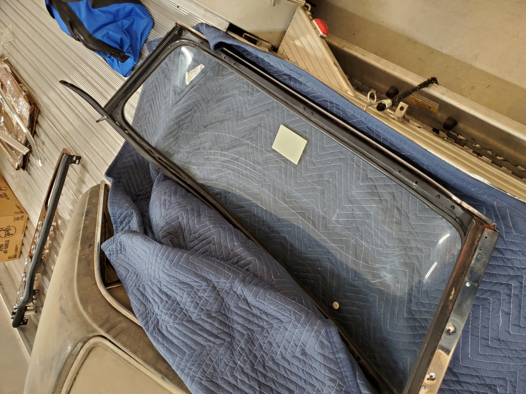

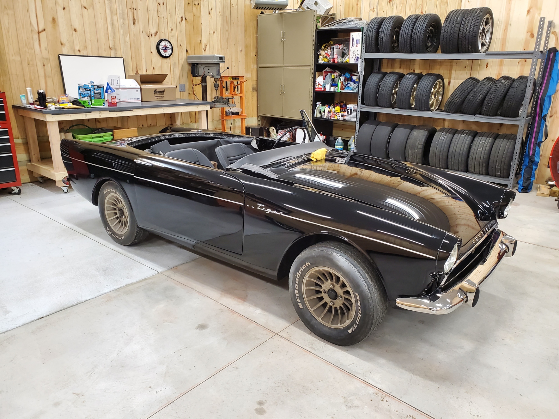

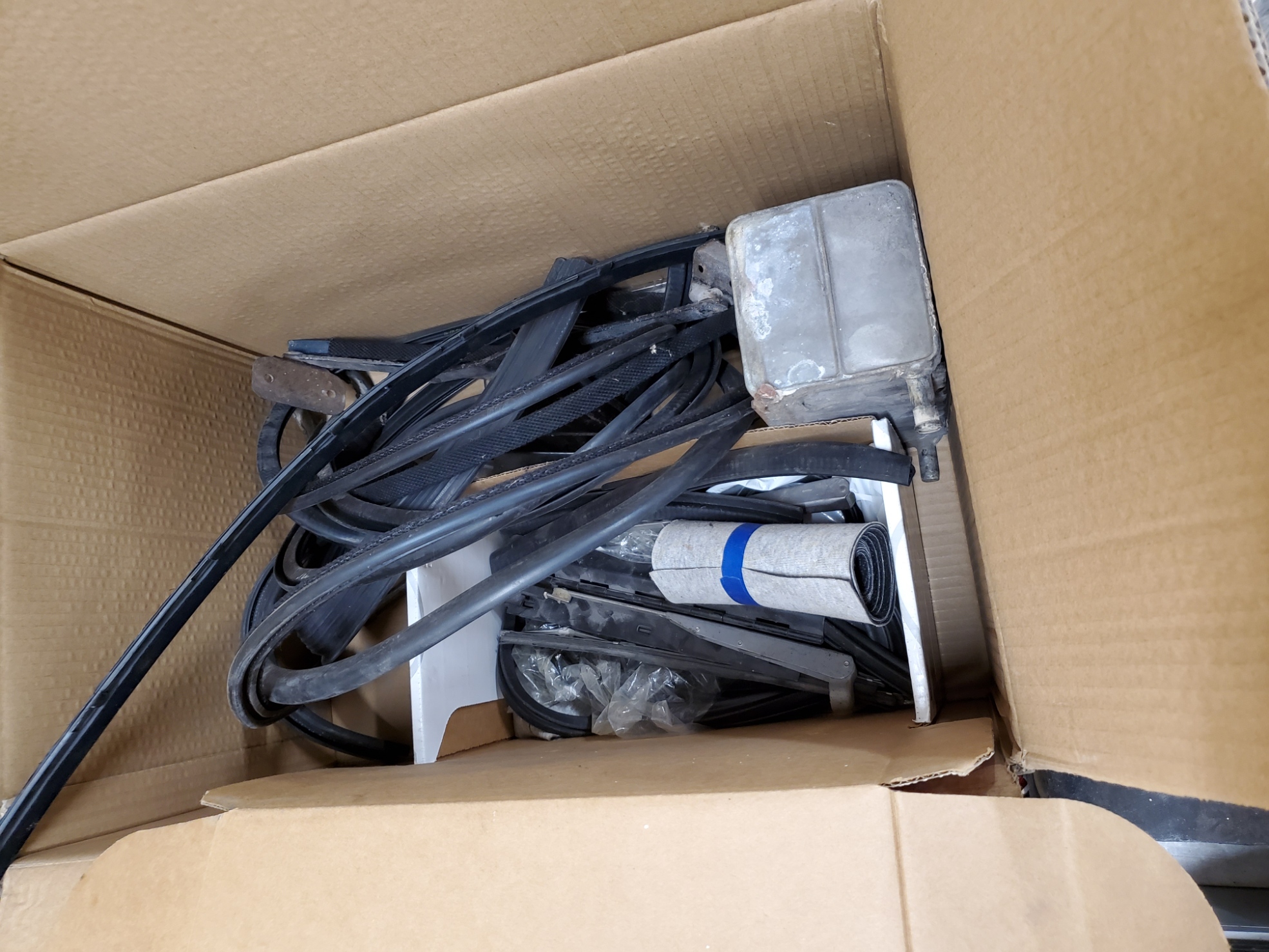

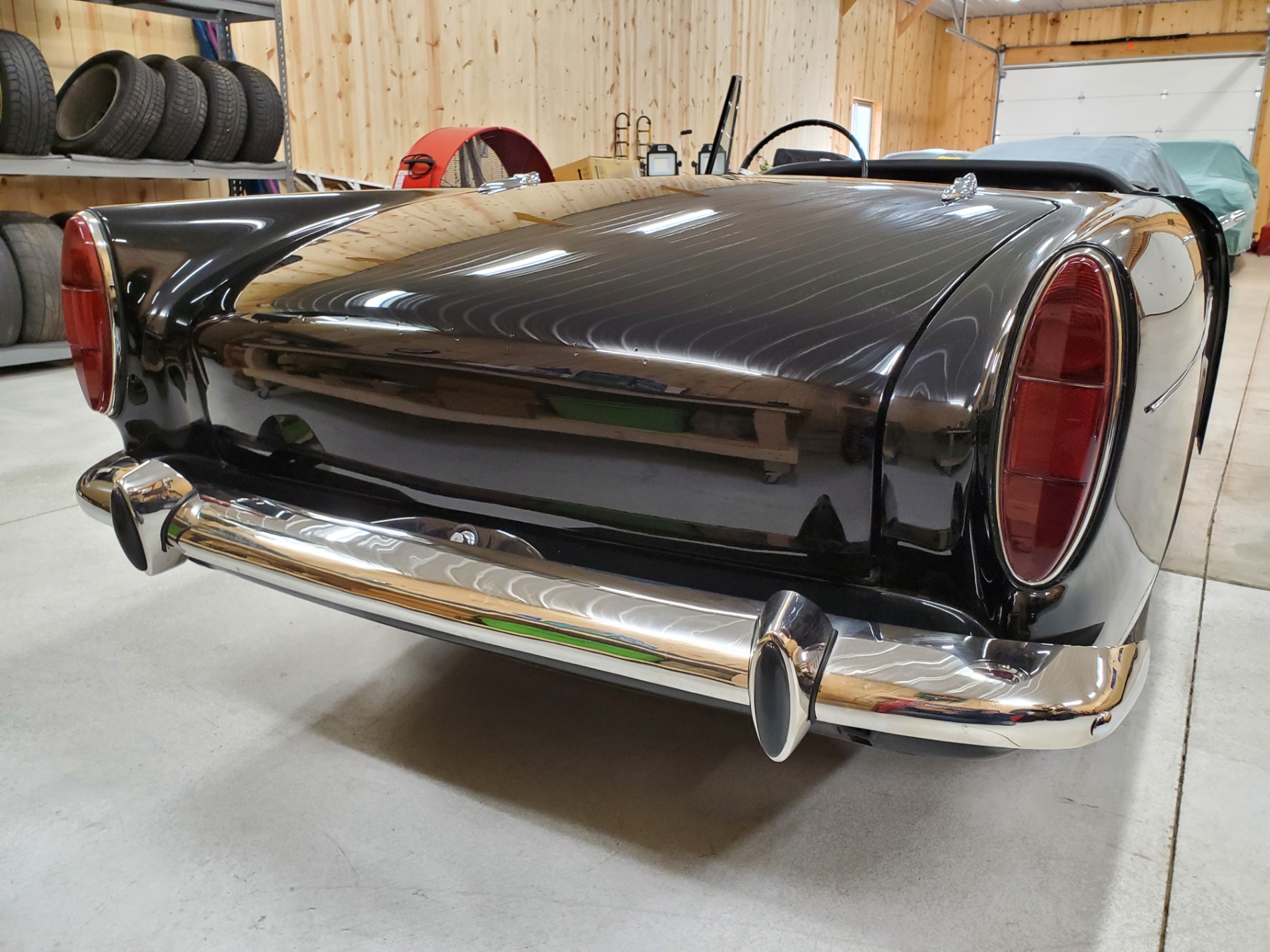

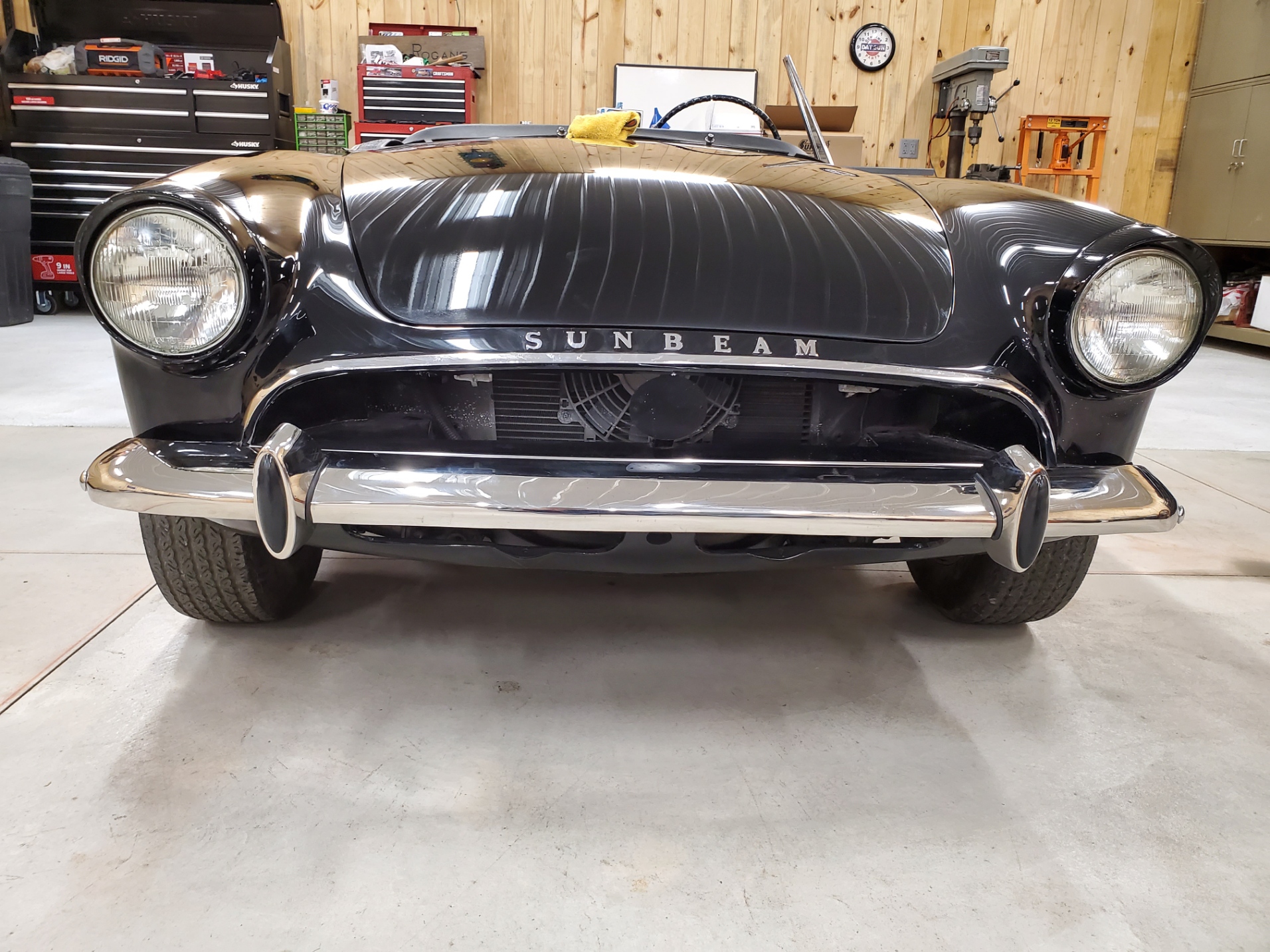

This should be a fun project to complete. Here are a few pictures of the car as it was when I brought it home. I hope I can tap your knowledge of these great cars to finish putting this one back together properly.

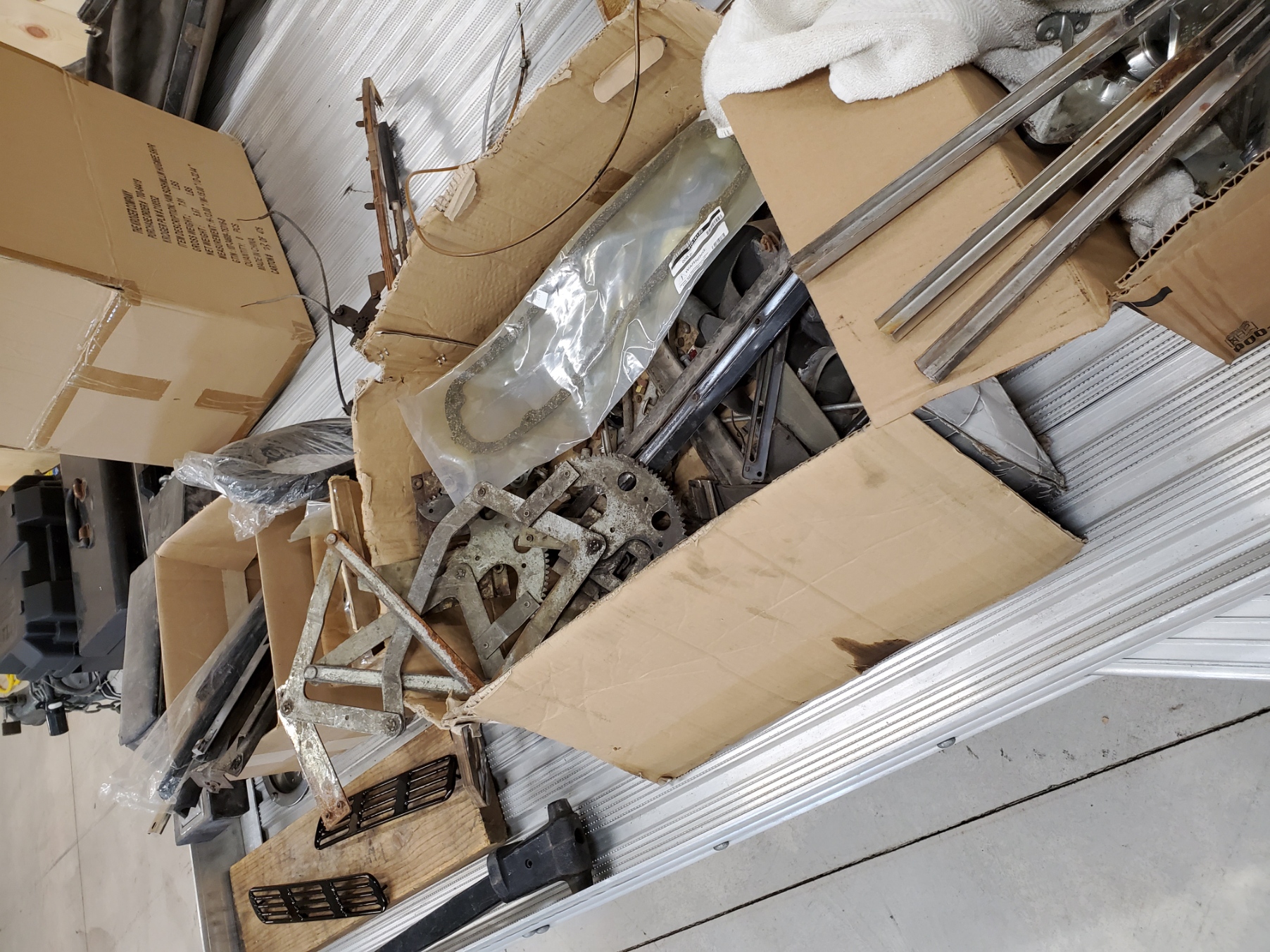

It appears that the restoration shop did a good job with the body work and paint. You have a 1,000 piece jigsaw puzzle, but no picture to use to put it together. In addition to the folks here offering their knowledge, there are a few references that can help you (but even they lack some of the details). I would suggest you consider obtaining a copy of the Rootes workshop manual for the 260 or the same one that covers both the 260 and 289. Also, since the Tiger shares many parts with the Alpine, the Rootes Alpine parts manual is helpful - as long as it includes the Series IV and V Alpines. Rootes issues a supplement parts manual for the 260 and later 260 and 289. Hopefully you already have these. Original books are available on eBay, but there are also CDs of these books at a cheaper price. Since you have a Mk IA, be sure that any Alpine parts book you get includes the Series V Alpine.

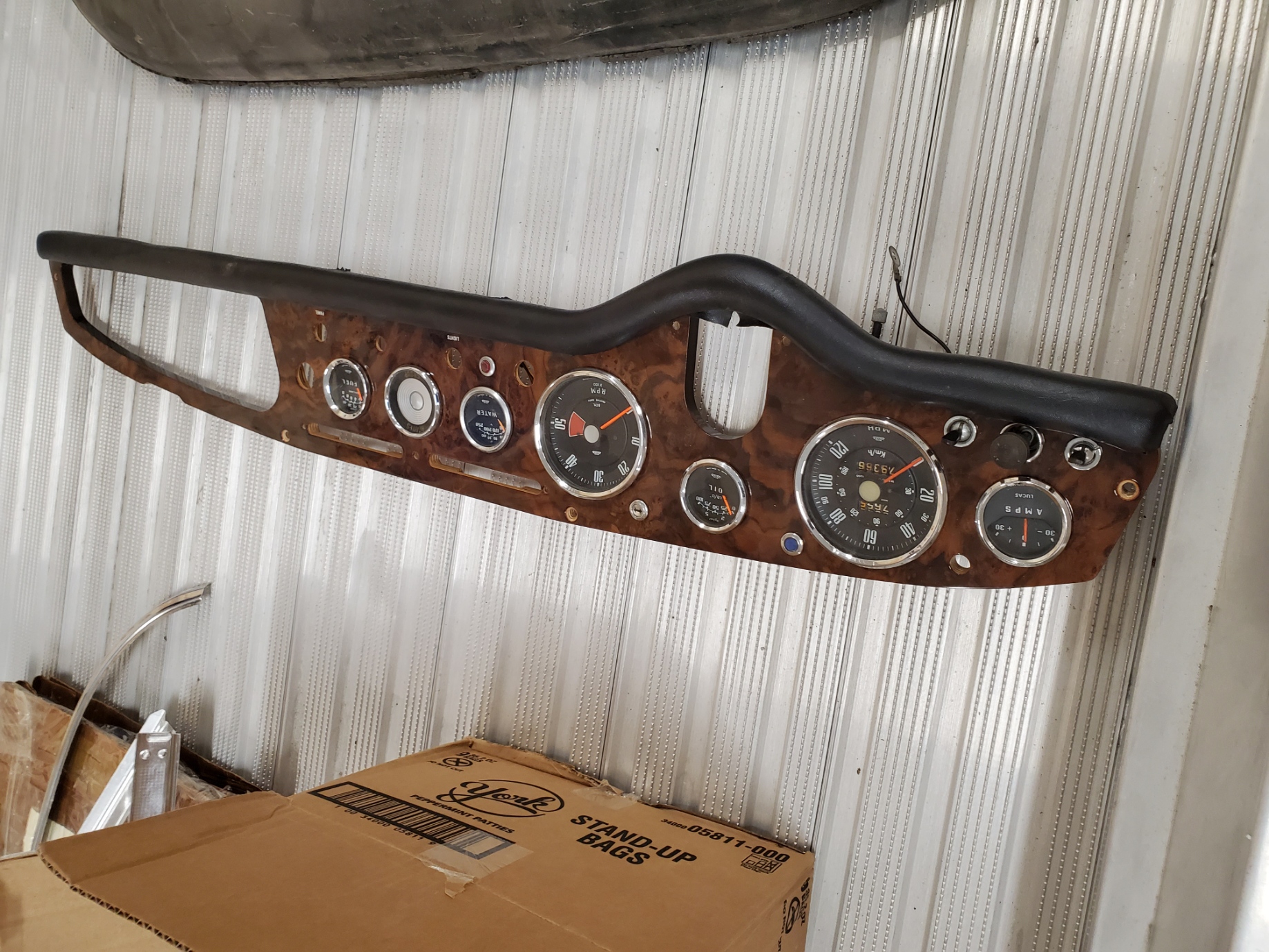

Nice start to a project.. You will need to find a Tiger speedo, i believe there are repro ones now available.

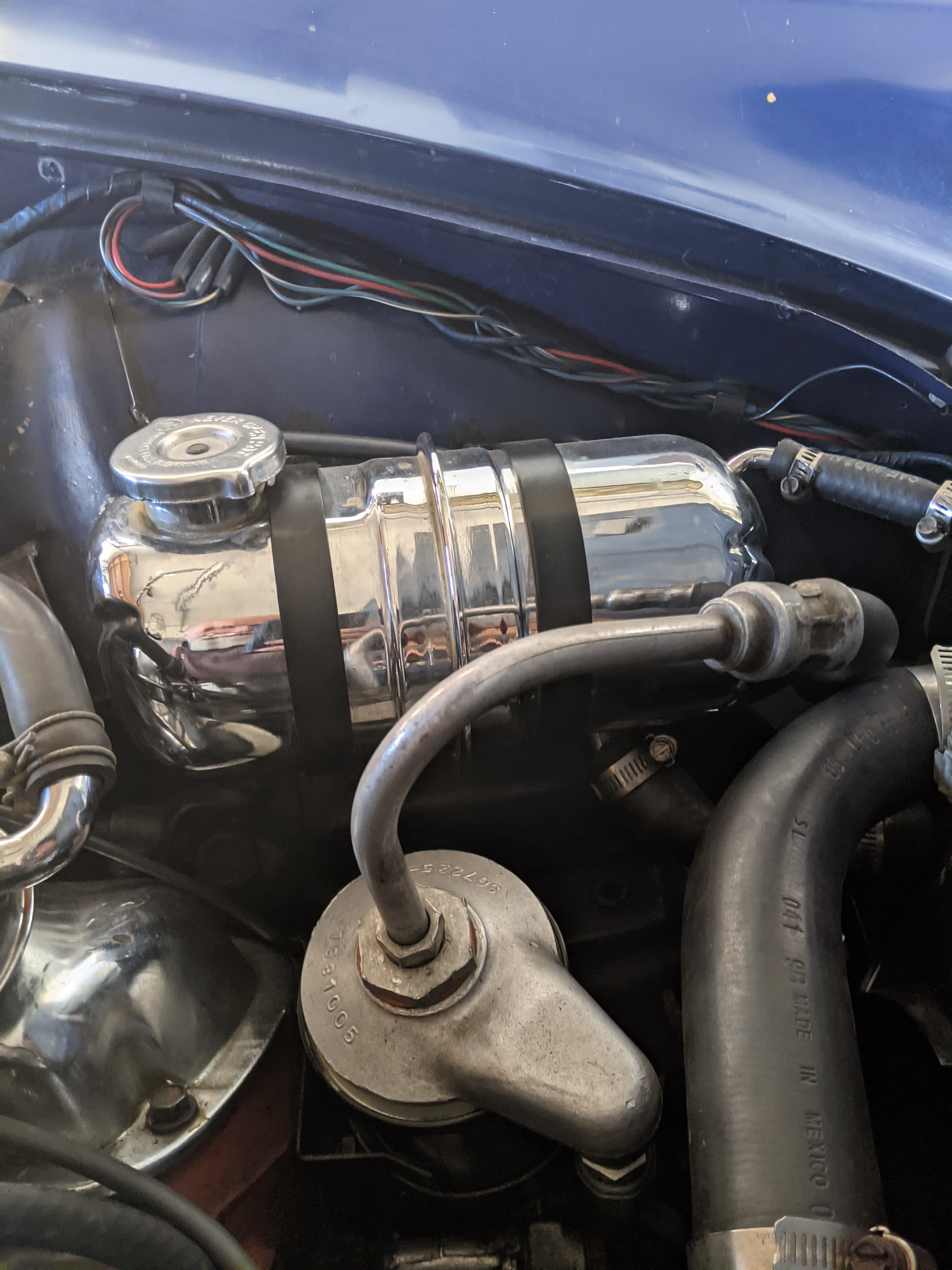

Same for the header tank, a group in the UK makes factory correct ones.

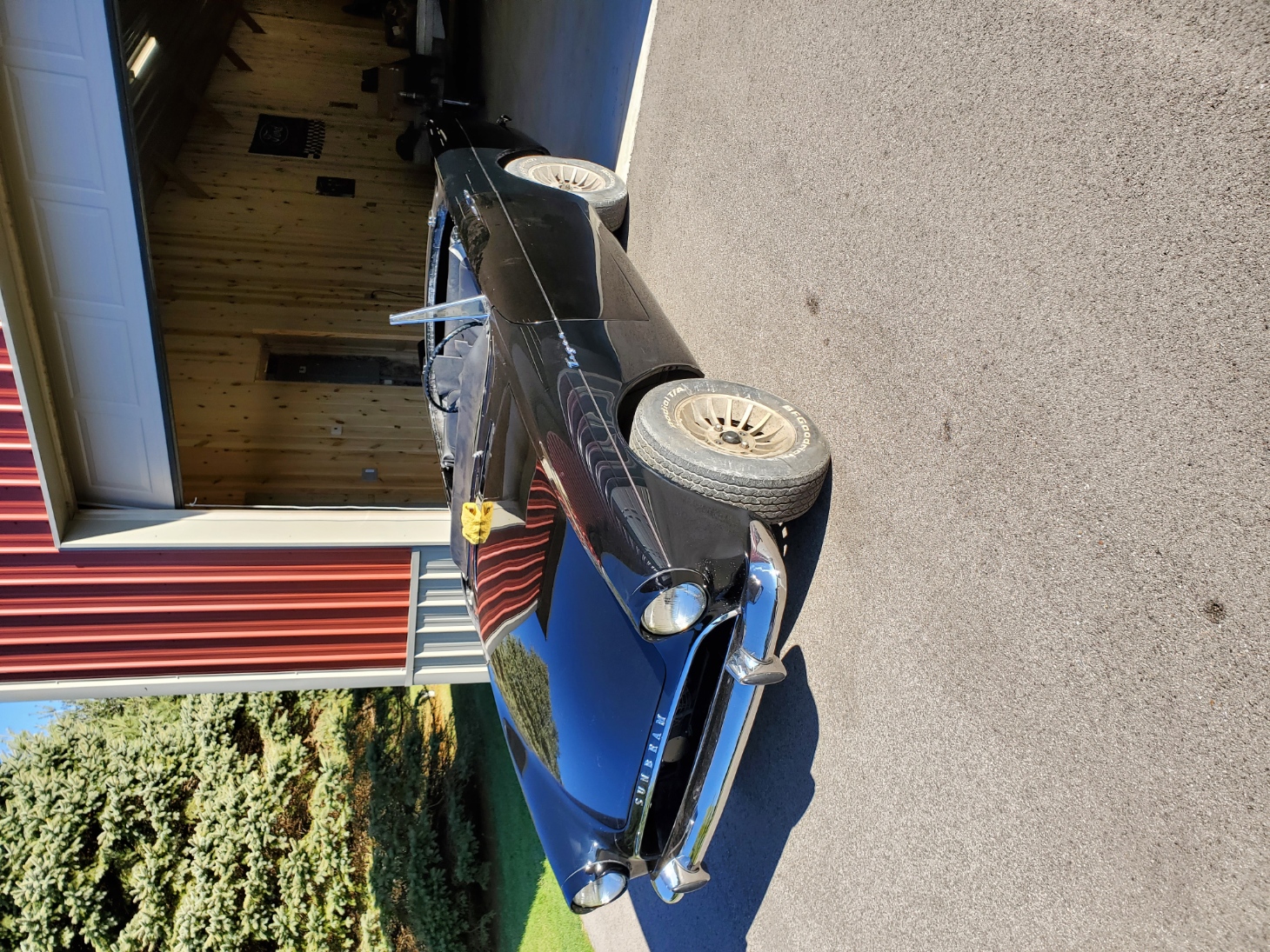

A quick warning on the front wheels.. The offset and tyres on those worry me a bit... If someone hasnt trimmed the fromt valence id be very careful to check that the leading edge of outer side tyre on the outside wheel when turning doesnt touch the wheel arch lip where it joins the valence.... Thry have a habbit of catching and will ruin your day.... And paint/wheel arch lip
Thanks for the heads up on the tires and wheels. I am considering getting some 15x6 Panasports. I will also need to figure out what size tire to get. I'll check the fender lip to see if it has been trimmed.

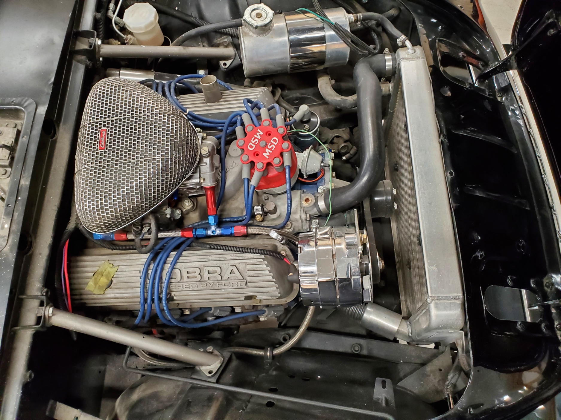

Well it sure looks like the modified crew has been at it. It has the 7" brake booster mount for the later serial #'s. The whole project should keep you in the garage for a while. Good luck & enjoy.

Nice Tiger! What is the paint code? Looks like it will keep you busy with assembly, since it’s been painted the hard part is done (unless there are underlying things). Have manuals you can use plus Tigers and an Alpine for examples. Bruce Paul in Milwaukee is a good source of information if needed, he’s done a few.-Al
Tank and
Stock AC housing are available. Rick at Sunbeam Specialties sells the Header Tank aka expansion tank if you want a new one. Ask me about the air cleaner housing. The picture is my spare tank they didn't come chrome plated. The original color is satin black .
