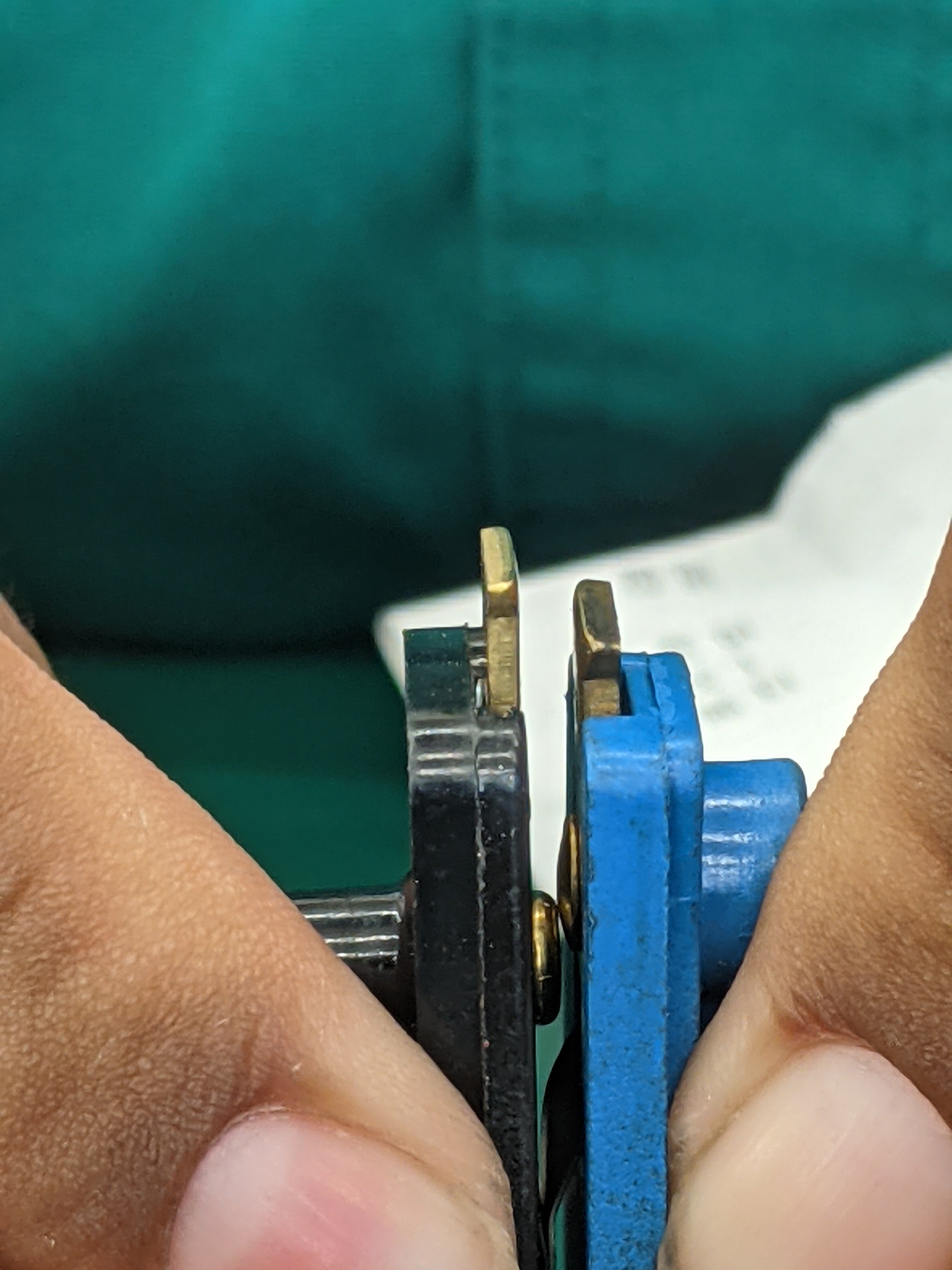

Dan Walters discovered a strange parts problem that might effect any of us.
When trying to trace an engine misfire, we were about to replace a rotor when Dan noticed that the two looked different. He ended up chucking a rod the size of a distributor shaft into the lathe and placed the black rotor on it. It fit snugly. Then he moved a cutting tool so that it just made contact with the tip of the rotor.
(pictured below)
Later he removed that rotor and inserted a blue one. He did not move the tool. There was a large gap between the tip of the rotor and the tool. The gap measured .084".
(also pictured below)
Has anyone else noticed variations in rotor sizes supplied for Ford distributors?

Certain standards have been constant over time but others have declined. A .84 gap would.. at the rotor disable a stock points ignition? Assuming an MSD capacitive discharge and fresh plugs? Might not be a problem? Or the problem is disguised, limited or masked by the hyper sparks created.
Thanks for airing this problem. Complete combustion of each particle:eek: of fuel introduced may become more than a competitive issue.

Since you can buy the caps and rotors separately, one would expect that they would all be made to some standard specification. It occurs to me that maybe the Ford specification is just in terms of the air gap between rotor and cap terminal. Since there are two sides to a gap, maybe one needs to always replace the cap and rotor at the same time, with parts from the same manufacturer. (Probably a good idea to replace both at the same time anyway...) That all aside, does anyone know what the gap is supposed to be? Gene

I'll take a stab at the gap to be similar to the point gap of .016 or .017.

The problem continues today!
Standard brand Blue Streak Rotor #FD311
The Ironic thing is, the rotor box says "Superior Quality Automotive Parts"
I would hate to see the inferior parts...

"Superior Quality Automotive Parts" TM
It's also 15 bucks with a limited lifetime warranty . Possibly a house fly's lifetime at O'Reilly auto parts. "Hecho en Mexico."
Correction they are 8 bucks and here's a picture of the new vs old POS. You can see the slightly exaggerated false perspective from the camera angle but it's a significant difference. More $ isn't always better.

Being a cheap Yanqui, I normally just gently bead blast the older units clean and they are good for another 60K miles. The stubby rotors will manifest as the rpm increases and mimic "point bounce" . . . . .A high energy coil is not always a good thing as some unwanted arc welding can take place inside that crowded cap.
It's the El Cheapo at O'Reilly auto parts sorry no p/n. I often used to take a little emery cloth to freshen up a rotor but on Dan W. advice got a fresh one.
