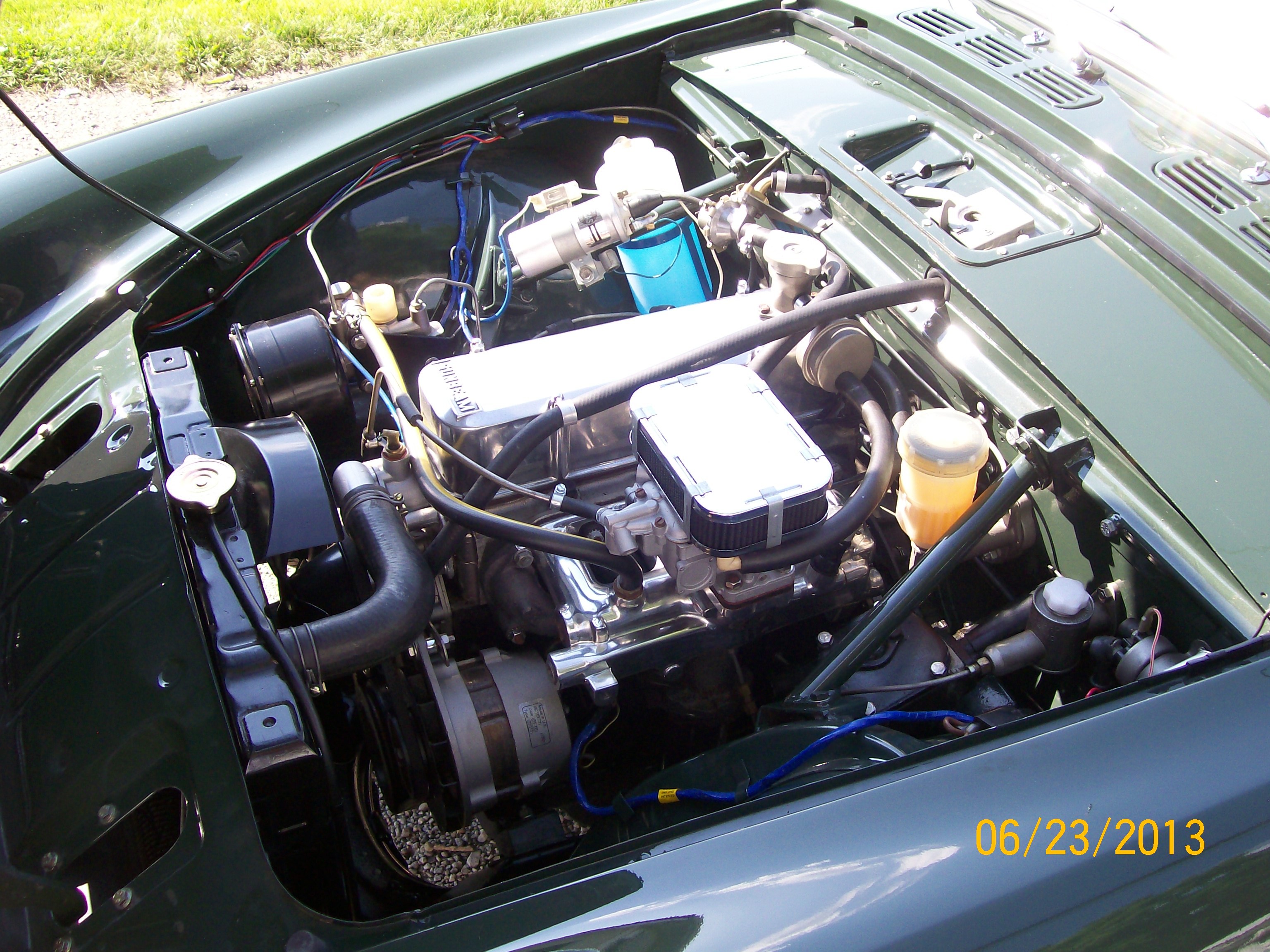

As promised, here's the pic of a tiger reservoir. the difference between the Tiger and Alpine is that the metal threaded port that inserts into the master is square cut on the Tiger. The alpine part has a male flare as it is threaded into a female union on a separate brake line between it and the master cylinder.
You can use an Alpine reservoir for the Tiger but it won't be possible to get it oriented centered with the master. The Tiger unit can be dismantled in place, accurately centered, and then reassembled. the metal connector is splined which locks the reservoir in place once the inner nut, washer and seal are compressed.
