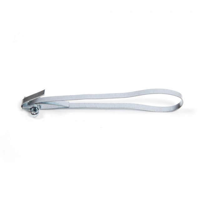

Sold it on eBay I do have a picture of it someplace but I'm away from that laptop till the end of the week. It looks a lot like that one that they sell on Moss motors that we talked about.
Is this the one from Moss?

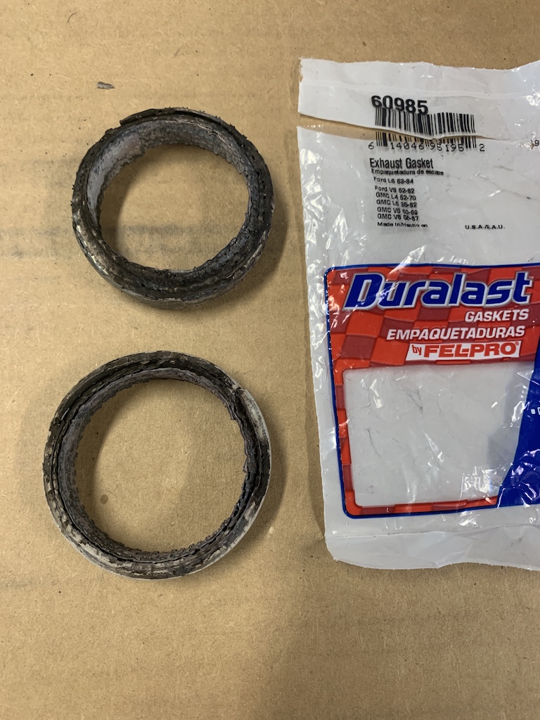

Exhaust Donut Gaskets
Replaced the fiber type exhaust donut gaskets that started failing already. If you run cast exhaust manifolds, use the solid soft metal alloy ones like the Fel-Pro 60985 or similar.

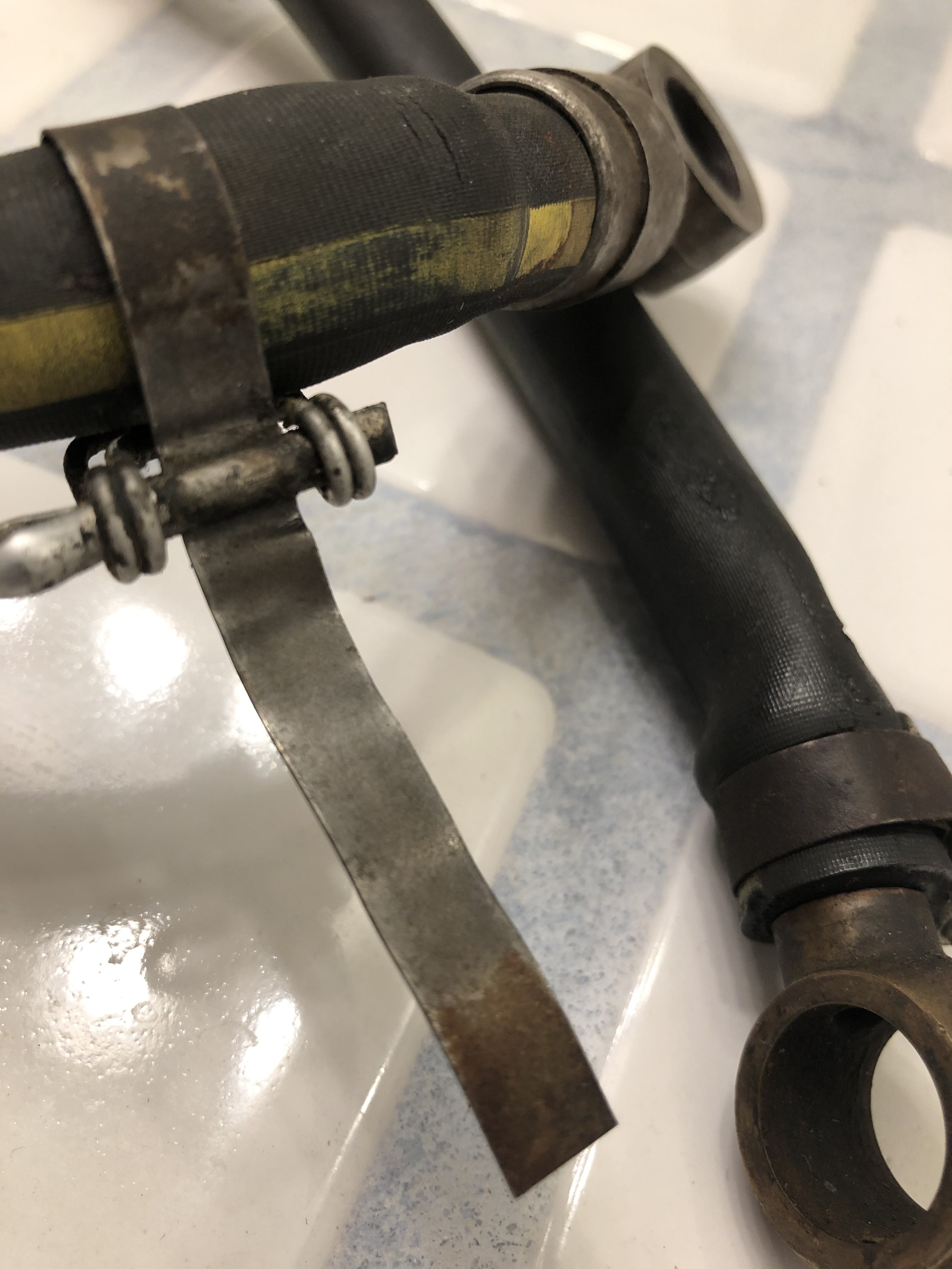

Per the sardine clamp I sent you the picture of the Moss catalog online.
The original one I sold because I thought I would never need it, oops..

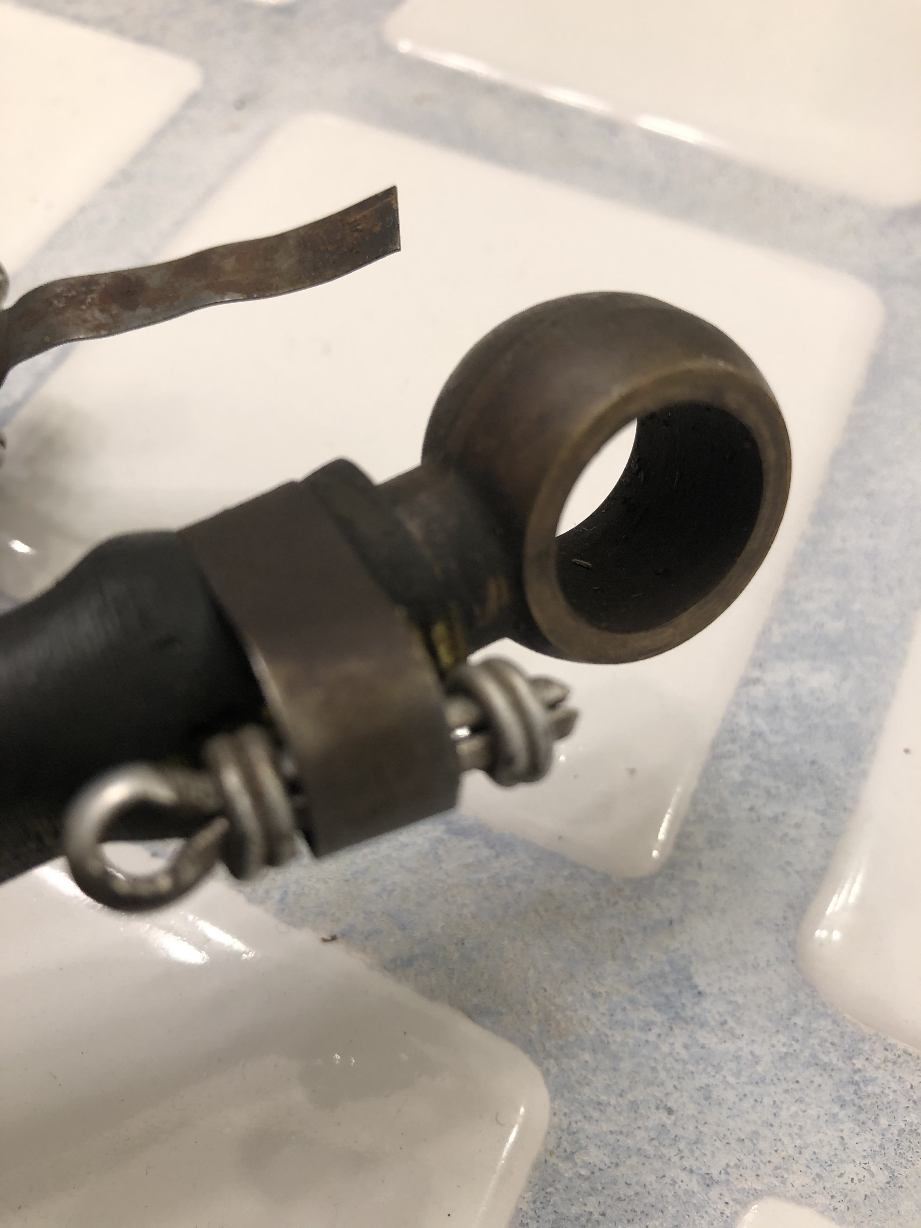

I will locate this week. The do not seem to be a more than one use item but for those seeking originality I suppose you could glue the hose too.

Here are a couple of pics of original servo hose and clamps you can see I opened one up carefully
Thanks, Bryan happen to have a used one in his stash of stuff that I was able salvage and install:

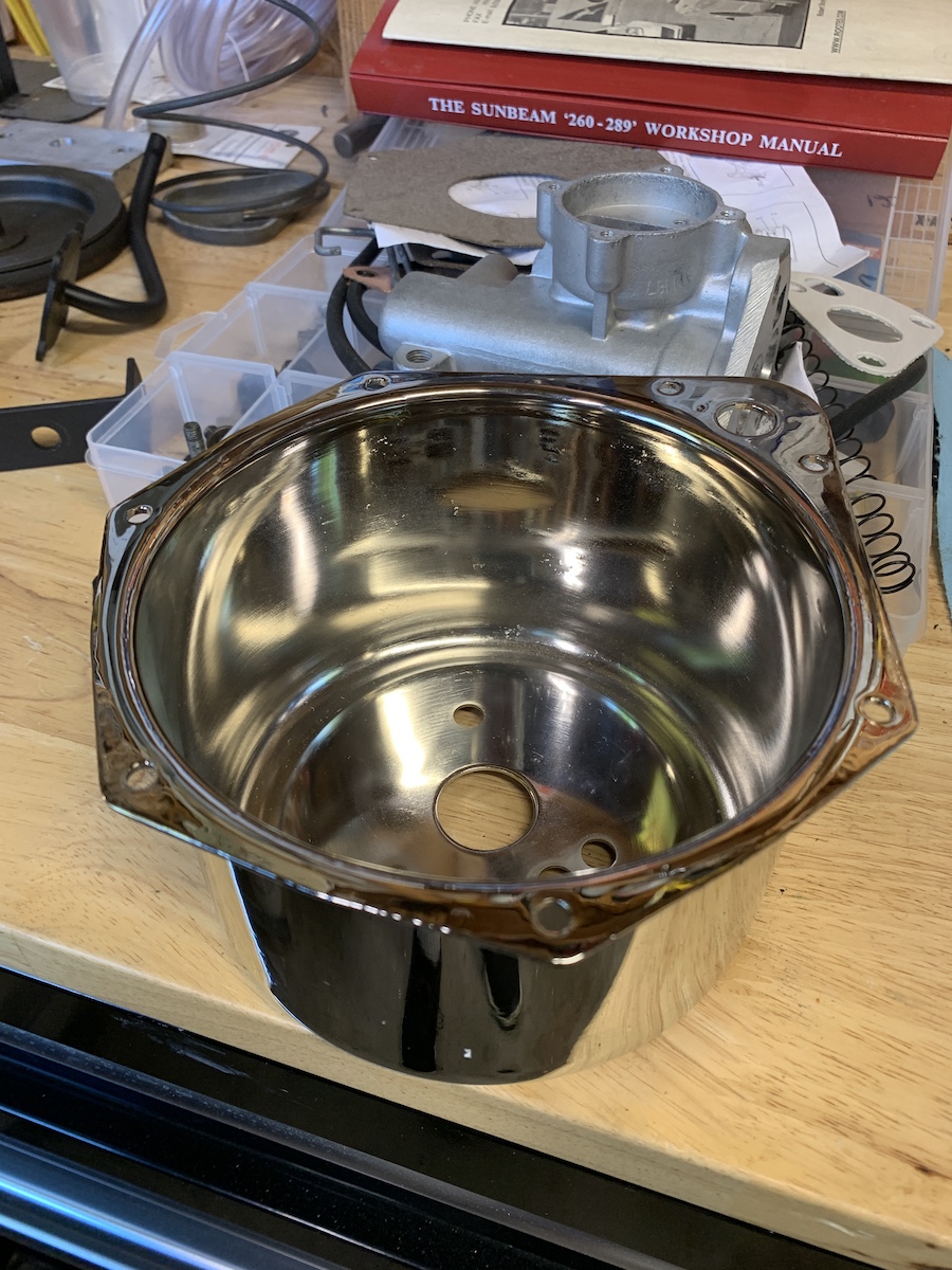

While I'm here in this old thread, here's a few things I've done since my last post.
Had the brake booster chromed and rebuilt it:

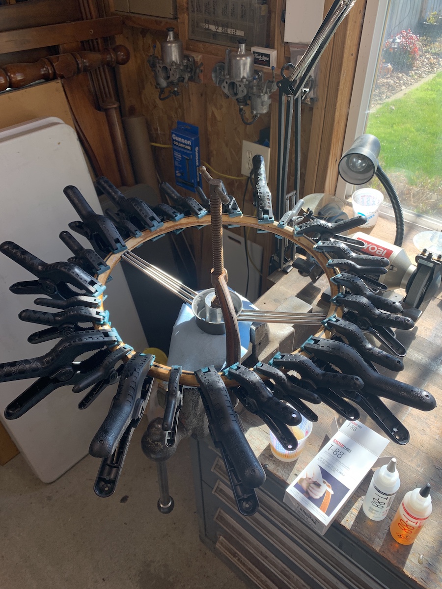

Took apart the steering wheel and glued it back together:

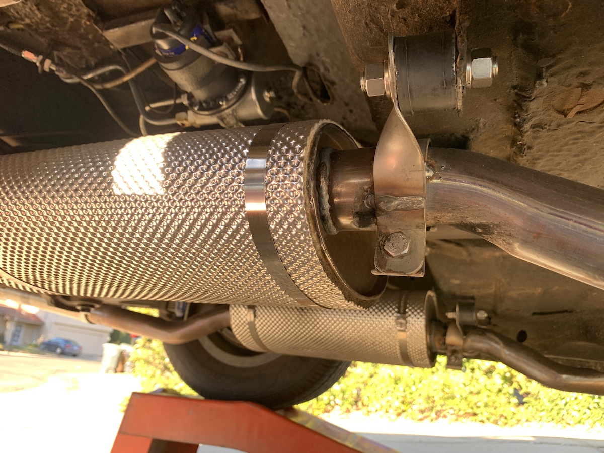

Wrapped the mufflers to cut the heat going to the fuel pump a bit:

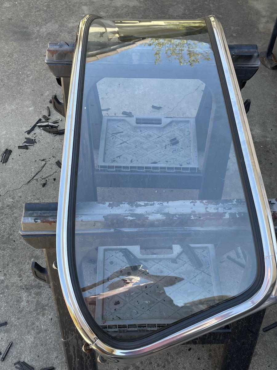

Finally replaced the windshield rubber, and didn't even break the glass, luckily:
