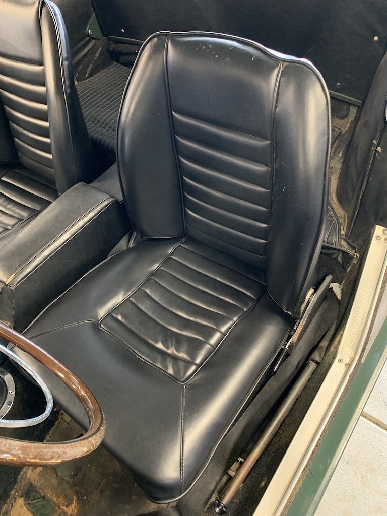

I'm debating on the seats whether to recover them with a new kit, or try to salvage the covers. They aren't bad, looks like a cat put a few claw marks on the upper shoulder area of the seats, I guess appropriate for a Tiger. Regardless, the foam is falling apart and a few of the straps are broke, they need work.
Ken, really enjoying watching you progress. My own BTDT... 4-5 upholsterers refused to consider repair of original seats. They had some busted seams and the response (without prodding) from each was that technically yes, they COULD re-stitch, but would expect the vinyl to tear during or shortly after any repair. DIY, is maybe a good idea. In my case, was sentimental about sitting in pops actual chair, so left it alone. Not the best choice, as W says "ashes>dust". Of a number of the other interior finishes, the new seat materials look pretty dead on (i'm super super picky) relative to (most) carpets, door cards, console and dash options. I'll repair soon, because my ass hurts at this point.

We resurrected a long stored code 86 tiger. We saved the original sewt covers and installed new foams. We had a shop fix 1 split seat sidr panel by using an orginal door panel to donate the material. We also used the same to recover the original piping around the seat edges that had disintegrated over the years.
Thats now 2012...and no new splits etc.. So it can be done... Just patience and time and a sypathetic trimmer.

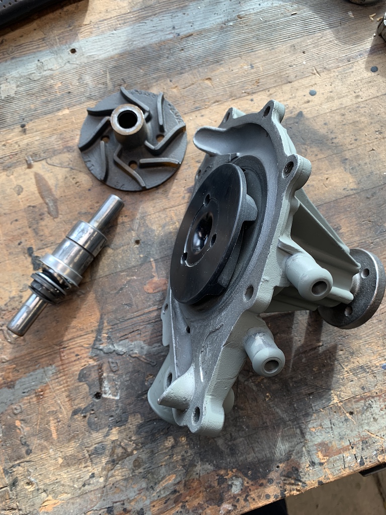

Water Pump
I finally got the water pump back from Dead Nuts On after sending it out Dec 28.
You may be looking at the most expen$ive SBF water pump ever, well at least for me. :rolleyes: Bought off ePay, supposedly rebuilt and ready to go. It had a slow drip so sent it off the Dead Nuts, opting for their Boss 302 impeller. Put a Mustang radiator hose spring in the lower hose just in case this thing sucks so much. At least I have a hipo C3OE-8512 impeller out of this misadventure.

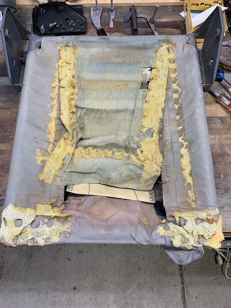

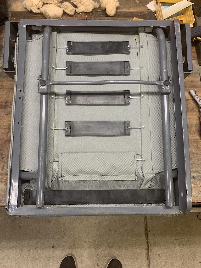

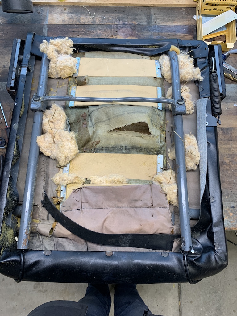

Seat Repair
I took both seats apart to replace the foam and support structure, which was shot. Did refer to this excellent article from Tigers/Alpines East on seat repair. Pretty sure the bottoms had been repaired in the past, weird looking straps, foam with holes, and odd cotton tufts on the bottom. So instead of gluing the covers to the center of the foam, they ran pieces of cord from the seam through the foam and canvas, then tied around these cotton balls to pull the seat insert down. At least I didn't have to mess with glue when removing seat covers. The drivers frame needed a couple welds on the front, which I guess is typical. Redid the support canvas and straps, which really is over complicated for what it does, and hopefully the old school Weldwood glue will hold up.
Still looking for an old MK1 drivers side carpet that someone wants to part with. :)

TAH_Tiger
274
Seat Height Adjustment
Not to get off topic, but after looking at pic #1 of the bottom of the seat, it reminds me of how many newer Tiger/Alpine owners are not aware of the seat height adjustment bar shown.

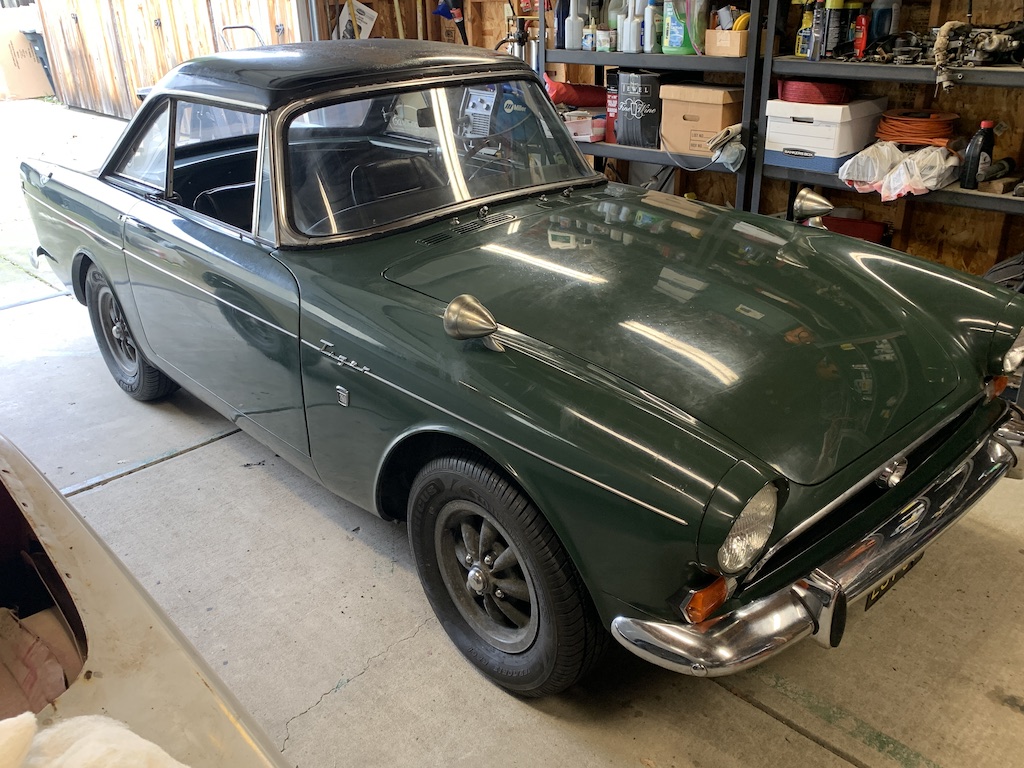

Back On The Ground
Got the brakes bleed, wheels on, and back on the ground.
Thanks Larry for the carpet.

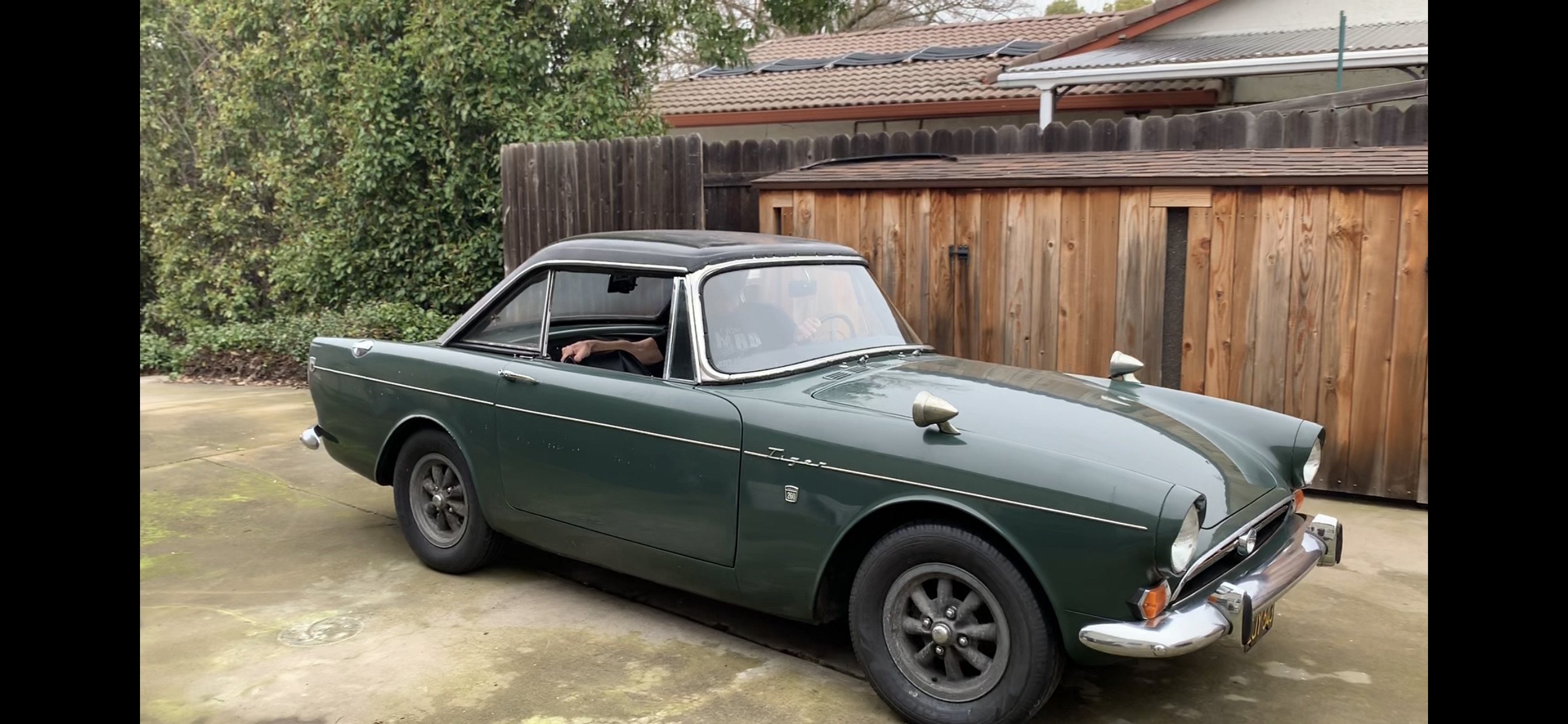

First Drive
Took it for its first ride around the block! It's been five months since we pushed it down the street into my garage, a bit longer than I thought it would take.
Video here.
Now I've got another fix-it list of stuff to do. It ran good, needs a little clutch adjustment and gauge/wiring work.

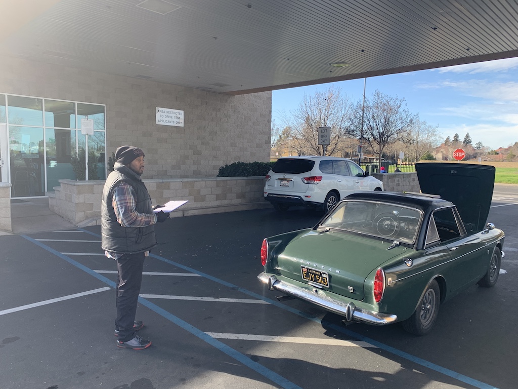

DMV Adventure Day
Well, took the car to the DMV today, barely, and got it registered, kinda. Took a couple hours. First, the car quit running on the way there, more electrical gremlins.
Nursed car into the inspection line. Guy gave the tag a look over and he wrote B9471532LRXFE on his sheet. I explained the suffix really isn't part of the chassis number, but I think once he's written it down, it ain't changing. At least he got the B in there and the first part right, and I didn't want to push it. I also showed him an old Tiger Tales VIN Tag article he could refer to if needed. He glanced at a picture or two, but didn't pay much attention to it. For the model year he took the year off the old title, 1966. I explained the car was built December 1964, date codes, blah, blah, 1965, blah, but no budging there either. He looked at the old black license plates and noted them on the form too.
Get inside to finish transfer with a nice young gal who seems to be doing fine until she pulls out this envelope with a new pair of white plates to put on the car. I say whoa, I want to retain the plates that are on the car, on the old title, since plates are perfectly usable. She gets an older lady who has seen black plates before and seems to know the ropes better. She jumps on the keyboard and changes, cancels, changes, looks for a job-aid for that type transaction, etc. While that is going on I notice a printout where the first gal typed CRXFE in the VIN instead of LRXFE, so I pointed that out. Older lady gets the VIN inspector guy to question him about his writing abilities and asks me to take him out to the parking lot to have another look at the VIN tag. Got the L confirmed and straightened out, and I pay the fees. The guy also wrote CP for coupe on his form. I showed the lady pictures on my phone, explaining it's a convertible, kinda like the old T-Birds, removable hardtop, which she agreed was a convert and changed. Lady then explains the original plates are in suspend mode until they go through someone higher up and approve that they are not already being used, vulgar, etc., which may take a few weeks. Hopefully no one will find the old ELJ 543 plates as objectionable and approve them for use. Anyway, high five for them for spending an hour getting it straightened out.
Now to get the critter back home. It runs for 1-3 minutes, then quits. Gauges sometimes stop working too, but it's not consistent. Give it a little break, and it will start again enough to get further down the street. Decided to call AAA and have it towed home. I'm thinking the ballast resistor on the generator may be suspect, since a few weeks ago it would start, but quit when key released to on position. And I'll be cleaning and grounding more connections. Maybe I'll throw the points back in there and swap coils to eliminate the Pertronix.
Anyway, always an adventure to go to the DMV. But I have to say, I think they've improved a bit over the last few years. With the Real-ID swarms coming in they knew they had to make some efficiency improvements.

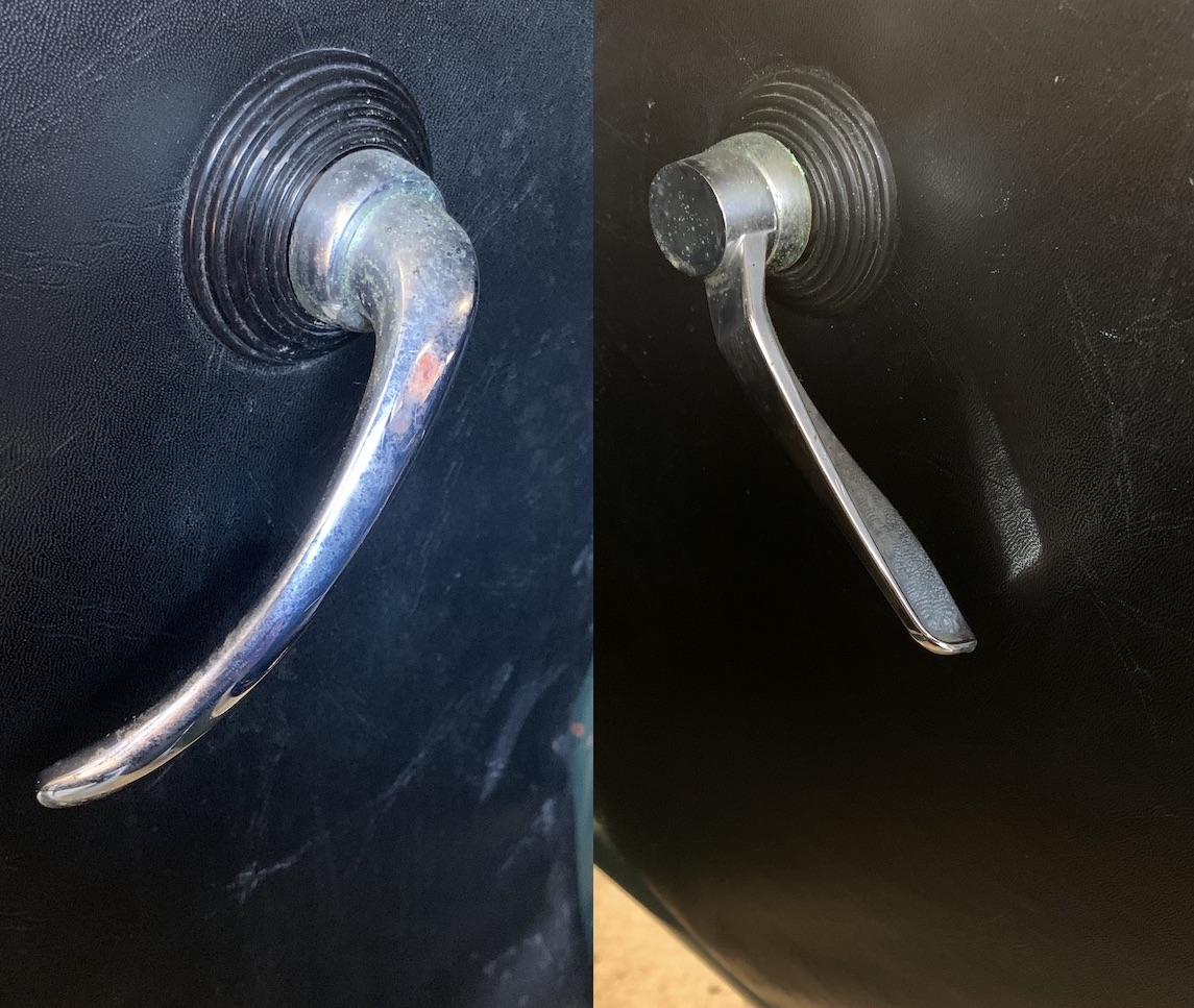

Inside Door Handles
I noticed I have 2 different inside door handles. pretty sure the one on the right is not correct, and not sure what it is from.
If any anyone has a door handle for sale, please let me know.
Thanks, Ken
