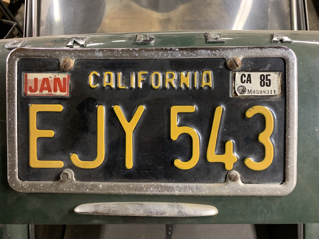

I'm thinking when I take the car to the DMV for a VIN check, which I need to do since the car has dropped out of the DMV system, I can leave the old original plate on the back and put one of the new ones bolted in place under the front bumper, inconvenient to get a close look at (not that it would matter). Then it would fall under the "Retention of old license plates" rule, not the YOM method that costs more each year. I've got the original 1975 title with the EJY 543 plate on it. If that fails, which I don't think it will, I can always go the YOM route.
Under the California DMV YOM License plate rules, it states:
Retention of Old License Plates (not YOM license plates) on Collector Vehicles
Under specific circumstances, DMV may allow a car collector to retain the old license plates that were originally assigned to the vehicle.
The original or photocopy of the California title or registration showing the plate number originally assigned to that vehicle must be submitted with the application.
The plate configuration:
— Must be available.
— Not in a series reserved for issuance as any other plate series.
Check with your local DMV office.
I see in the photo that it has the stickers - as I understand it these must be also on the plate.
No, a sticker is required only if you are going the Year of Manufacture route. When my car was restored, it had not been registered in California for over 30 years. (It was never registered in another state, either.) I still had the title (pink slip). My license plates were restored along with the car and the stickers had been removed. However, I was able to register the car at the DMV. At first, they wanted to give me contemporary plates, but I pointed out that I have the original plates on the car and the pink slip showing the numbers. They took my old pink slip and eventually issued me a new title paper. I believe to use your original license plates, you need to have title with that license number. Otherwise, you will need to go YOM route.

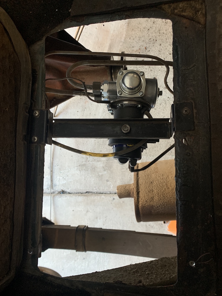

I took a small screen fashioned it into a small cone that fit inside the brass fitting on the inlet side of the pump. I can't change the stock condition of the car even if it is stupid. Got it set so the car will just starve for fuel if I start getting dreaded epoxy flaking syndrome. There are some nice heat shields on the market.
More than one time on my old motorcycles the floats would stick and the raw fuel would dump on the hot mufflers. If Sochiro Honda was not too worried about it ;) But seriously I know there is enough rubber in that new fuel pump that should be protected from the heat. Go MK2 style and move it to the boot spare tire well unless you are in the same stock configuration mindset as me on my newest old car.

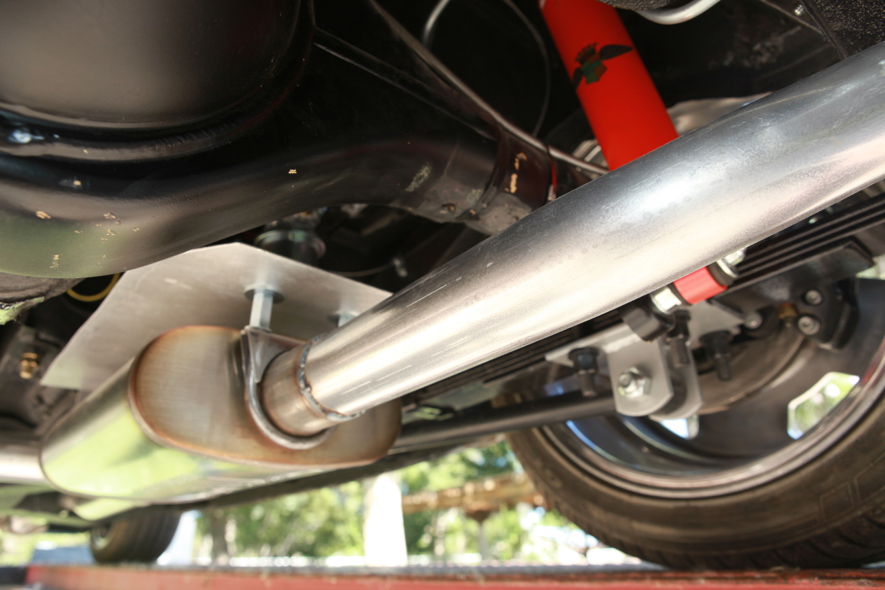

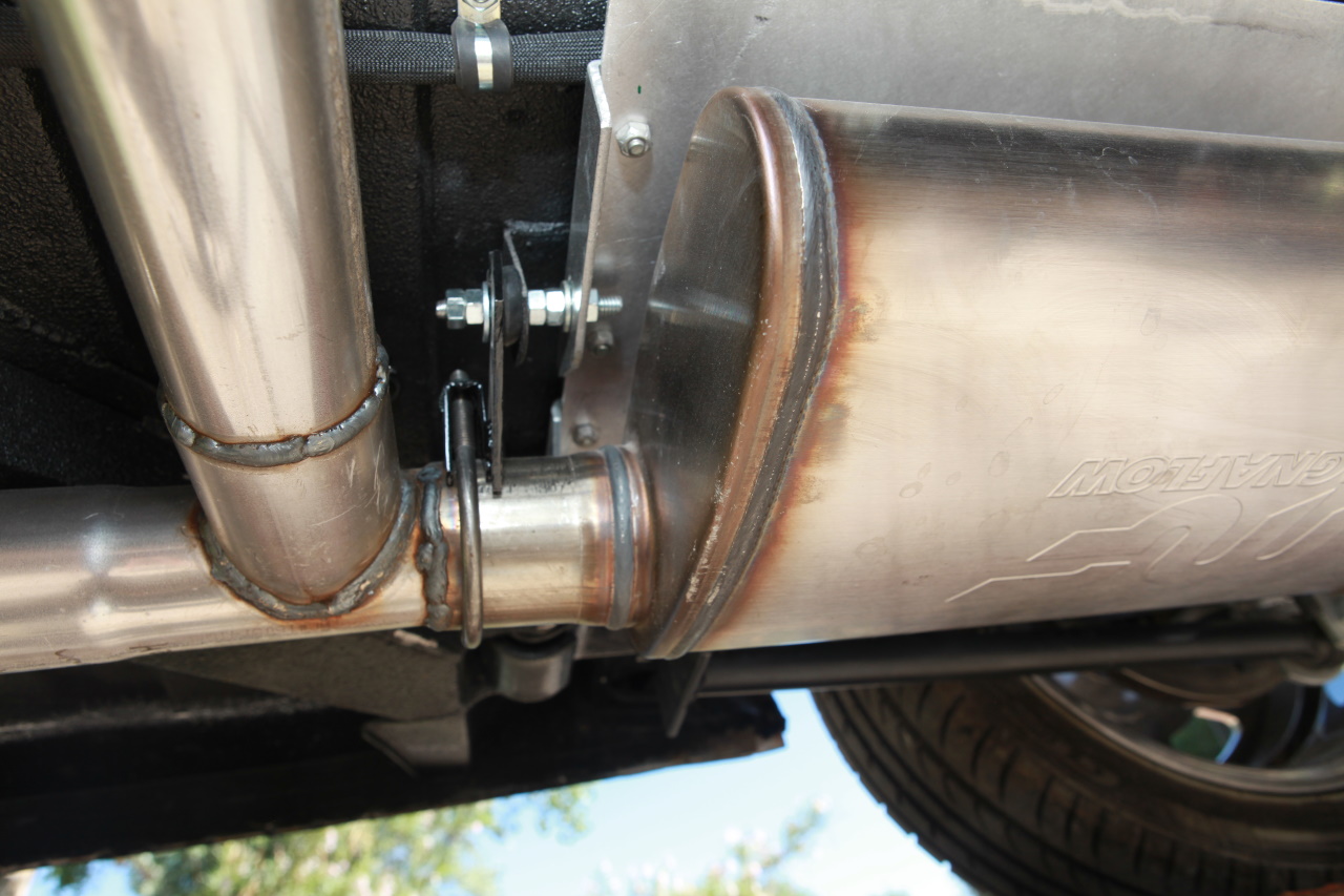

Here are some pictures of a shield for the fuel pump made for me by my friend Tommy. It is attached at the rear sharing bolts with the muffler clamp. Since the front outlet for the muffler is offset, the attachment is by angle aluminum and hanger. Cliff
That's a nice looking setup! Especially if you don't want to wrap those pretty mufflers with a muffler wrap. And it's out of view when looking from the back.
I ordered the stock SS exhaust $ystem today. I may try a muffler wrap, perhaps this DEI kit (that 1 star review is a bit concerning :confused: ).
Probably run as is and get a baseline with my temp gun, then after install to see how well it works. But, may end up copying yours.

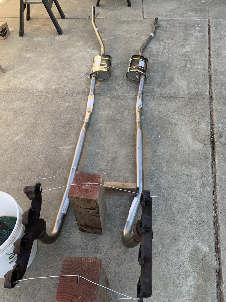

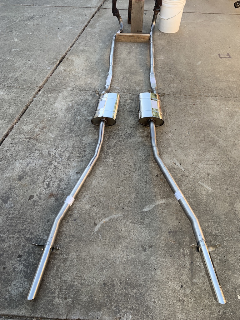

Got the exhaust system from SS yesterday, and today did a trial fit to make sure everything slips together without the big hammer when the time comes to install. The system doesn't include the downpipes, so those are an extra $131, so $656 total. Ordered the rubber mounts and a pair of manifold donuts as well. Clamps are not included either, I ordered 6 of these from Summit, instead of u-bolt style.

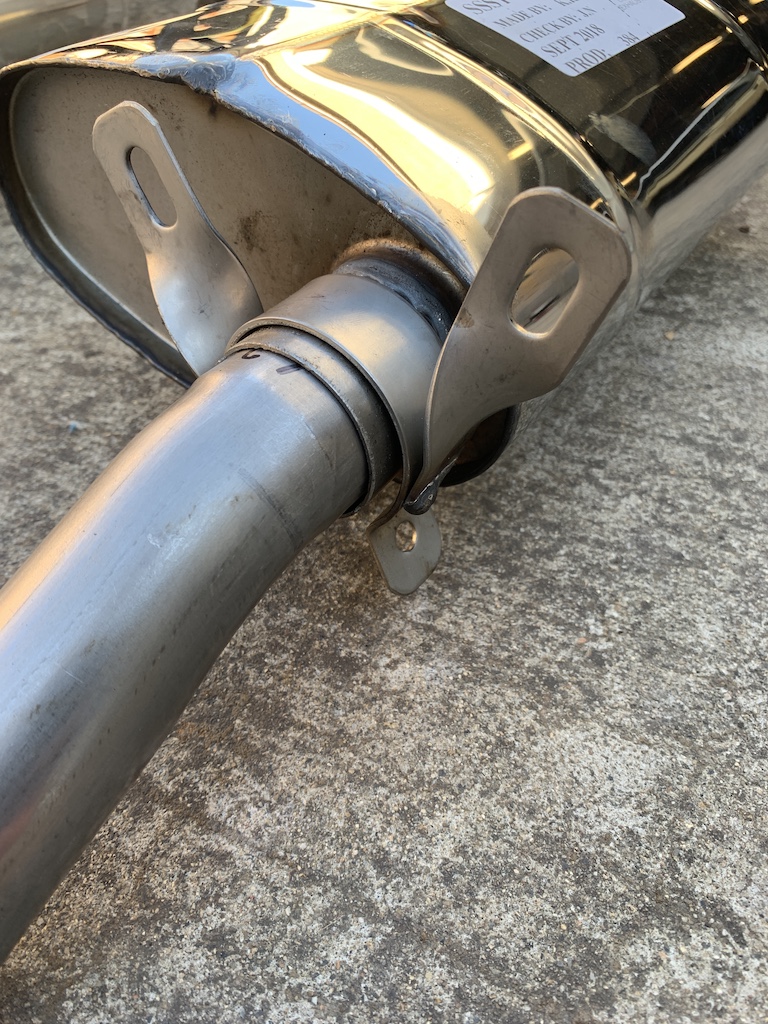

I slipped all pipes and mufflers together and marked a 2" line to be able to see how far pipe is inside the other. The only problem joints where the downpipes to the pieces going through the x-frame holes, which are flattened a bit to fit, which caused pipe to become slightly oval starting about a 1/2" in, preventing an easy fit. So, used the vice to make the first 2" round again, and also borrowed O-Reilly's tailpipe expander to open up the downpipes just a little.
Also, it seemed the left downpipe wasn't fitting all the way into the manifold outlet, and the donut gasket wasn't getting compressed enough. Choice of die grinder inside manifold to clear, or cut off 1/8" off the pipe end that fits inside the manifold. Chose cutting. And it did look a bit longer than the right before cutting.
The middle muffler mount is adjustable fore-aft instead of welded on like original, which is better I think. Oh, I need to get bolts for those 2 mounts too.

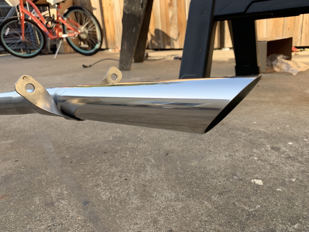

The tips look great and slide into the pipe to the muffler a lot to give you a bit of adjustment. It's shipped with a plastic protector.
Verdict, so far, so good. But final fit in car will tell. I'll install from the manifold and work to the back, and use Locktites Copper Anti-Seize at the joints to help disassembly. At least I know what I have instead of waiting to see how good of job is done at a muffler shop by some guy who's never seen a Tiger.
